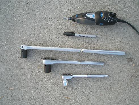

Tools used:
19mm socket
17mm socket
breaker bar
2 socket wrenches
sharpie
Dremel
#115 dremel bit
Jack & Jack Stands

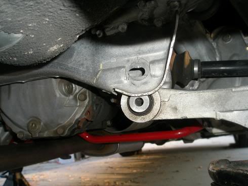

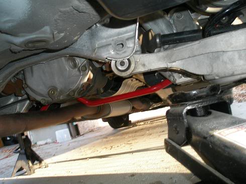

Jack the car up and place jack stands. Loosen stock toe bolt. Using hydraulic jack raise the bucket (control arm) slightly to relieve pressure on the toe bolt. Pull out the toe bolt.

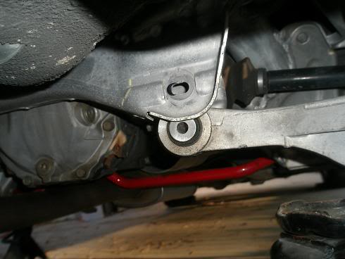

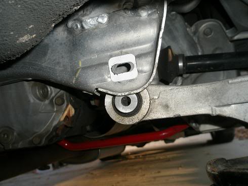

Lower the jack just enough to let the control arm past the hole. Place template.
Using a sharpie, color the sides of the hole to elongate. To save time since I don’t plan to put a lift kit on my car i marked only the INSIDE edge. Don’t forget to do both sides on the arm.
Using the dremel, carve away at the hole until you can no longer see your marker. Make sure that you have dremeled enough by inserting new toe bolt with washer and ensuring 360° travel.
