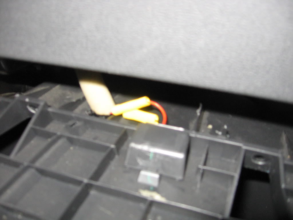

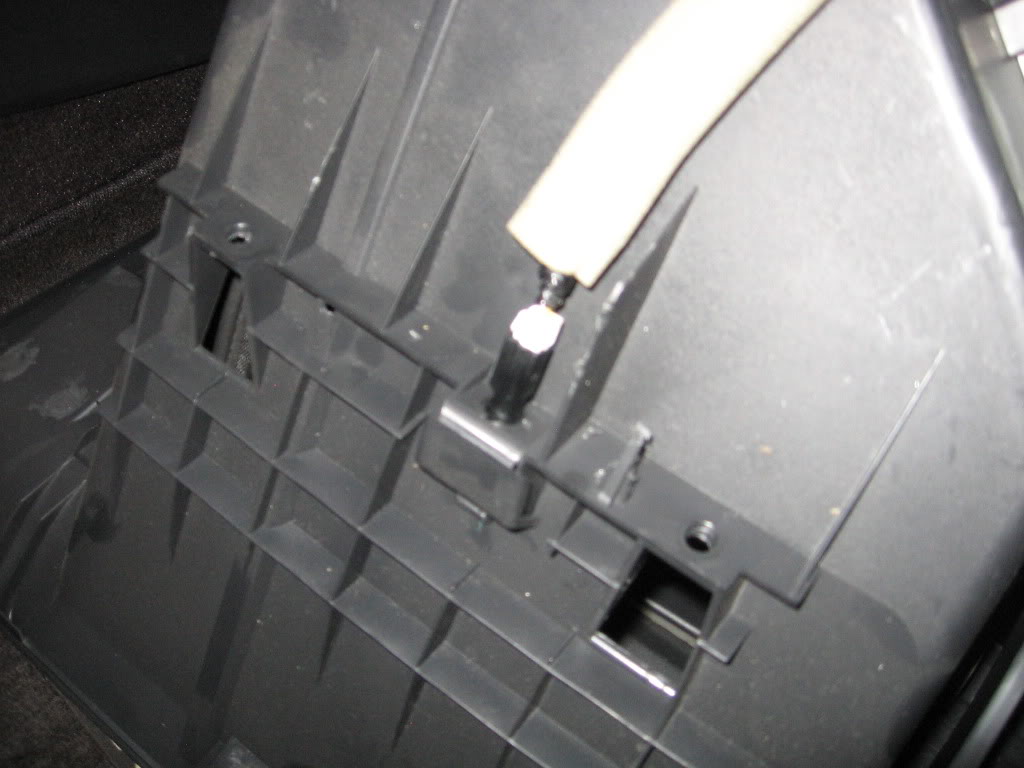

Pull the box out and turn the connector to pull it out:

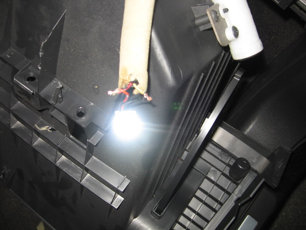

The connectors are different so cut the wires and test. Red goes to red(positive) and yellow goes to black(negative).
Make a good connection then stick the light to the same spot where original was and you done:
