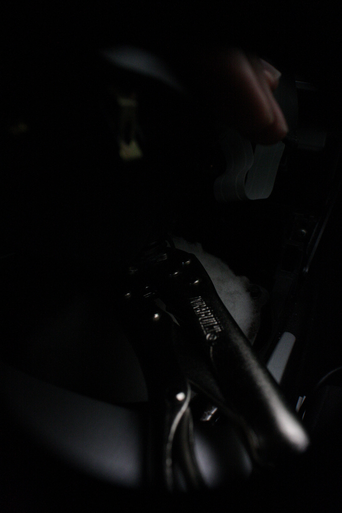

Now, you’ll see the part which the vice grip has to clamp onto. Most people use radiator hose so it grips better along with the vicegrip – Although, there is already rubber wrapped around the stem. DO NOT ATTEMPT TO UNSCREW THE KNOB WITHOUT SECURING THE SHIFT STEM WITHOUT THE VICE GRIP, you can damage your transmission.
Now with the firmest setting on the vice grip, clamp it and make sure the grip is strong enough so the stem isn’t going anywhere. The only thing you want moving is the shiftknob. Clamp vicegrips, and twist away.
Voila!
