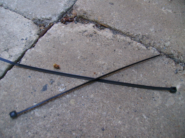

3. Zip Ties (Atleast 7 inches long)

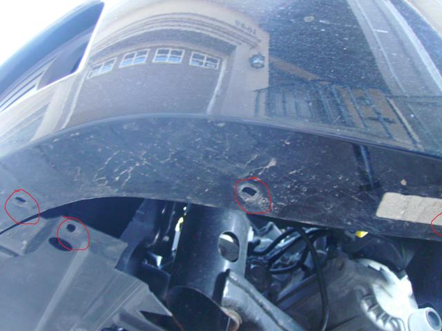

4. Next once the wheel is off put it face up out of the way. Next locate the three screws and one clip under the front bumper.

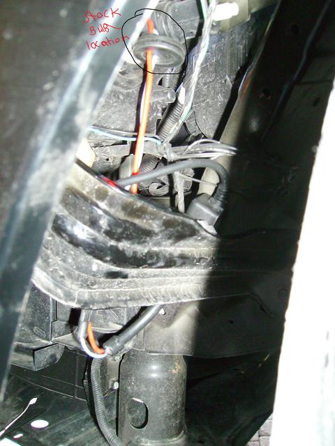

6. Next pull back the main lining located to the front of the wheel well, it needs to come out of the edge of the body panel that’s holding it in. It will only come out so far so basically it will bend back, bend it back so it touches your caliber and rotors and put something to hold it back (I used the lug wrench by putting the heavy side in the end hole of the lining). Now while its held back locate the stock bulb:
Altima HID
7. Remove the stock bulb by disconnecting the factory harness from it and turning it counter clockwise to remove it.

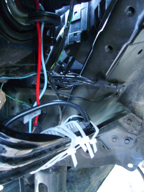

After making all the connections it should look like this:
Wiring HID Nissan Altima

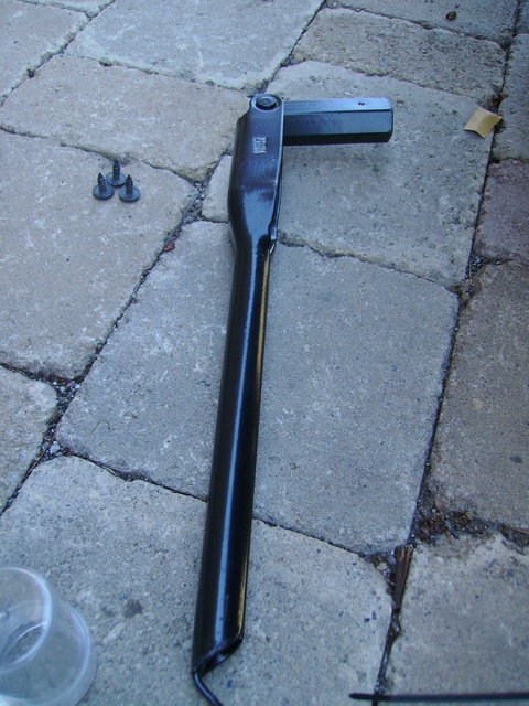

Find the support beam under the headlight. It’s a large black metal piece:
Nissan Altima HID
10. Zip tie the ballast to the support beam:
Altima HID lights
Nissan HID bulbs
Now make sure it’s all secure and the ballast won’t move, tuck the wires away or zip tie them as well to the support beam.
