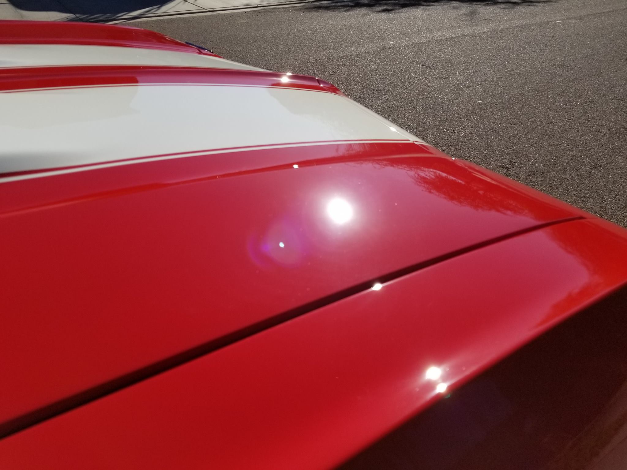

All photos are unedited pics of Ted’s work on local vehicles – We hope you enjoyed this informative article!
