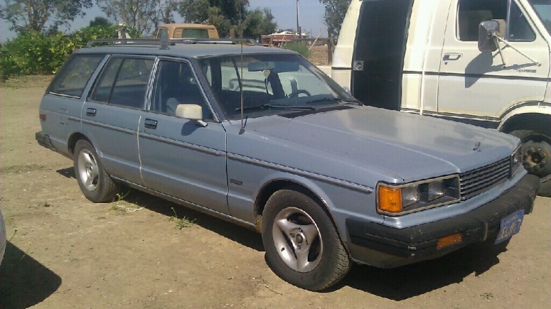

I traded a 95 BMW 525i in Aug 2012 for this 1982 Maxima Diesel. Here’s how it looked when I got it:

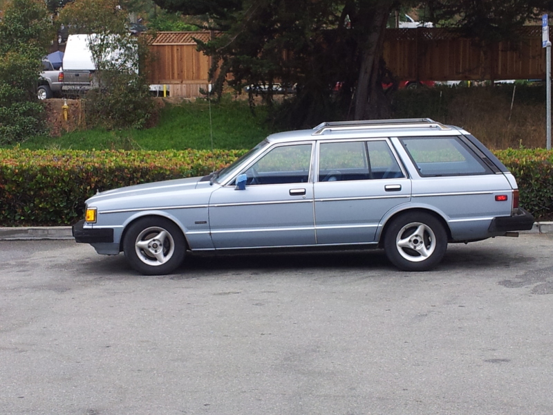

After some cleaning and detailing, it looked somewhat presentable – How about those sexy Prime 3-spoke alloys!

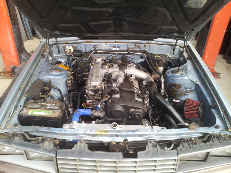

As soon as I got it, I did some internet digging and considered an L28et swap, but I really wanted to do another RB swap. Based on my experience swapping RBs into S30s, I thought the mounts and everything would line up well, being that the car was an L series derivative. It was close, but I had to modify a set of RB20det steel mounts and also notch the cross member to get it in perfect. The transmission mount and driveshaft bolted/slid right on. I used the RB20det transmission as the transmission tunnel is much to small to accommodate the big RB25det trans.

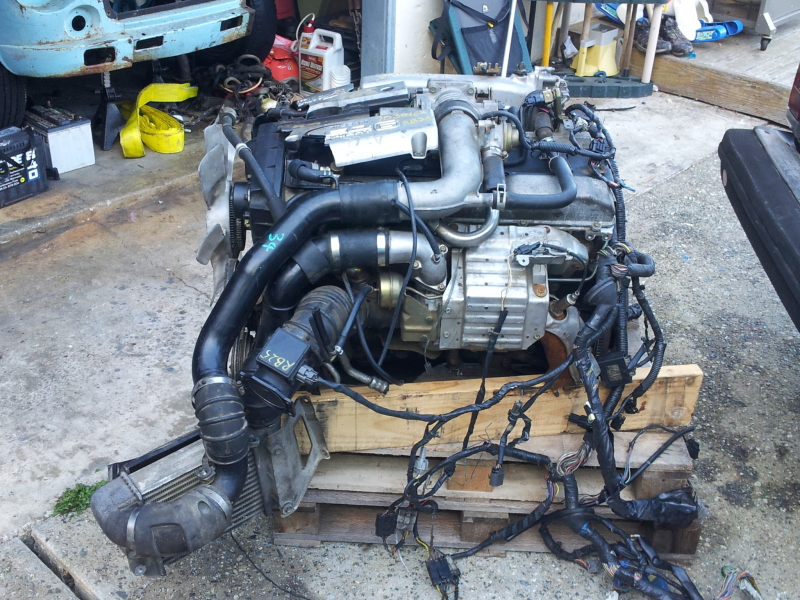

…and hauling her new heart transplant home:

The RB25det NEO has to be one of the easiest RB swaps to wire. It was much easier than earlier RB swaps I have done.
I deleted all the ATTESSA bits and replaced it all with components from a Series 2 RB25 as needed (like the TB and TPS sensor). I was then able to strip out all the ATTESSA components from the harness as well.
