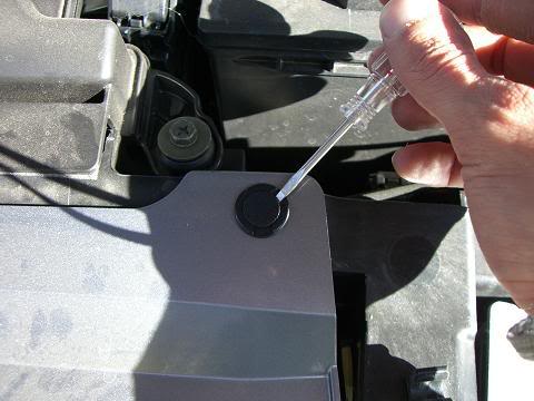

Step Two: Open Hood. There will be 8 clips on the top of the bumper.
Step Three: Remove Clips. Use the flat-head to gently pry up the clip’s center piece to where you can grab it with your fingers. Then, pull clip out of bumper and place in a safe location. The two center clips will be smaller than the 6 main clips.

Pop the clip
pop the clip
clip popped out
remove clip

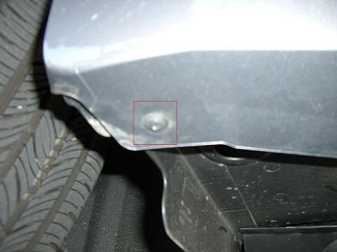

Step Four: Remove bottom screws. Underneath the bumper, there are 6 Phillips head black screws. Unscrew them and place in a safe location.
remove fenderwell screws

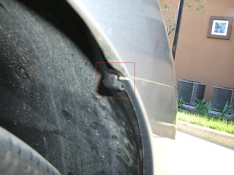

Step Five: Remove wheel-well screws. There is one screw in the wheel-well on each side of the bumper. Using the Phillips screwdriver, remove them by gently prying back the wheel-well plastic shielding and unscrewing. Place in a safe location.

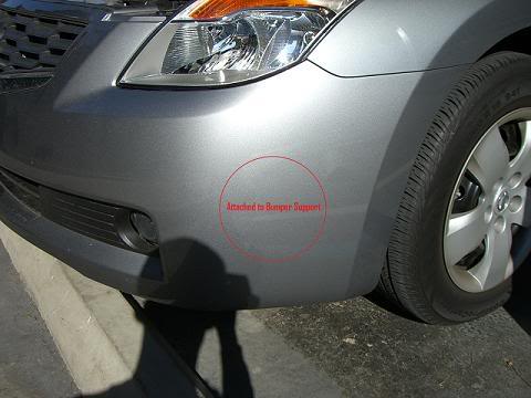

Ballast installation I believe is more a personal choice. I chose to attach to a bumper support under the driver’s
side headlamp and to a support in the engine compartment. Here are a couple of pics showing the placement.
ballast location
ballast mount location
