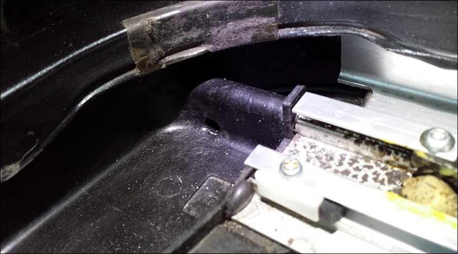

Start off by opening the sunroof. Easy enough. Then, remove the wind deflector. On this vehicle, it’s held in by two screws, one on each side. Then, you should see something like this:
Wind deflector removed

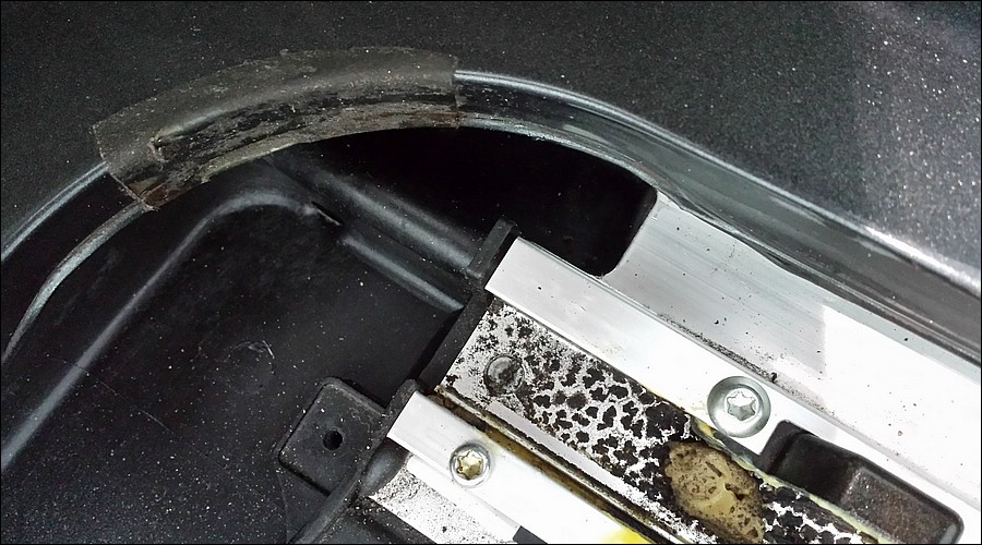

There should be two small holes on each side (yours may only have two total, as it may only have front drains. The Quest has front and rear drains). Here’s a better view from the top:
Different angle, wind deflector removed
In my case, both holes on the right side were clogged with some dirt. I vacuum cleaned the tray, wiped it down with damp paper towel and cleaned both holes with pipe cleaner. Soft wire may work as well. That did the trick for me. At least on the right side drain.
I though that was it, but after pouring some water in the tray, I found out that my left side drain was clogged as well. I tried pipe cleaner and wire again, but it didn’t work for me this time.

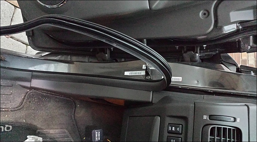

If this is your case, next step would be to remove your door weatherstripping in the door opening.
Pull down weatherstripping

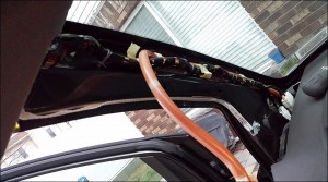

Remove the A pillar cover, and you should be able to see something similar to this:
Drain hose

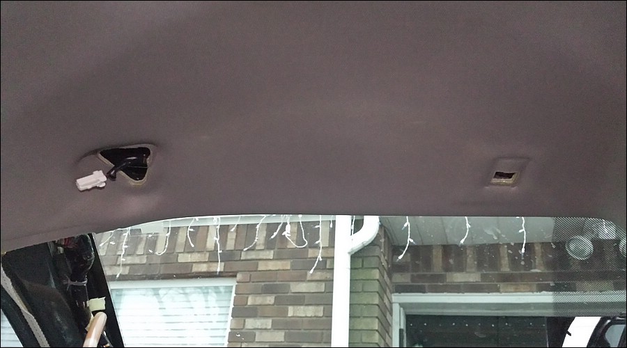

That soft, flexible hose should be your drain line. Next, remove the sunvisor:
Sunvisor removed, pull

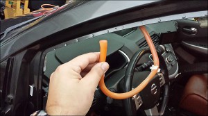

This should allow you to pull the headliner down just enough to follow that hose to where it’s connected to the drain and pull it off. NOTE! Get some rags ready, as there could still be some water and gunk in the lines.
top end of drain hose
Voila! The line is off! Now, there are a few different options you can use to unclog the hose. You can use a pipe cleaner if you have one long enough to reach the clog, or a piece of soft wire (being very careful not to snag the hose and tear it), or you can try to force the clog out with either a low PSI of compressed air or water. Don’t go full blast if you choose this option, as the hose could be old and weak, and you definitely don’t want a blowout. After you clear the clog, run some water from the hose through it just to make sure the clog is completely washed out. You just did all this work; You wouldn’t want to have to do it again, would you? Reassembly is reverse order, and you’re all done!
