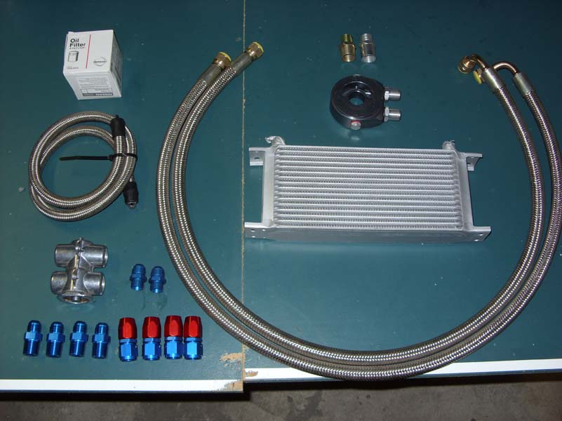

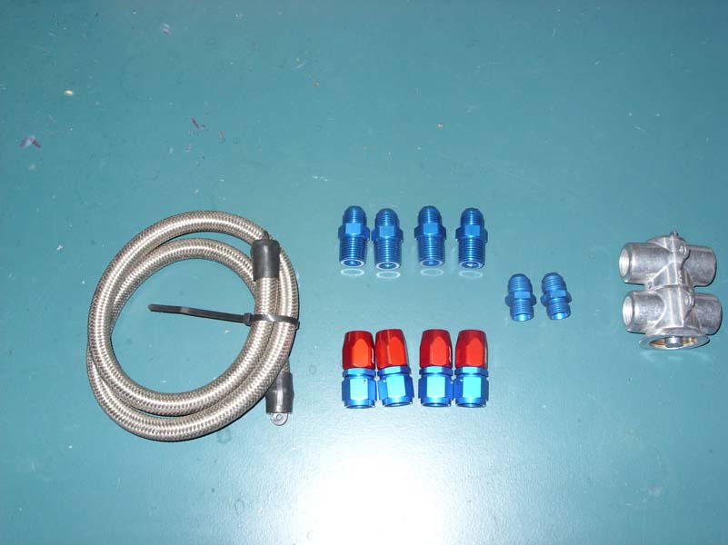

In addition to the oil thermostat, we picked up the following fittings to connect it:
4 1/2″ NPT Male to AN-8 Male fittings
4 AN-8 Hose ends
2 18×1.5 MM Male to AN-8 Male fittings
3 ft. Stainless Braided Hose

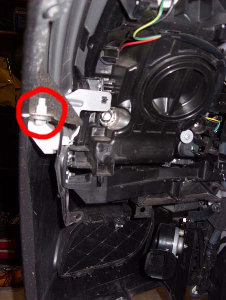

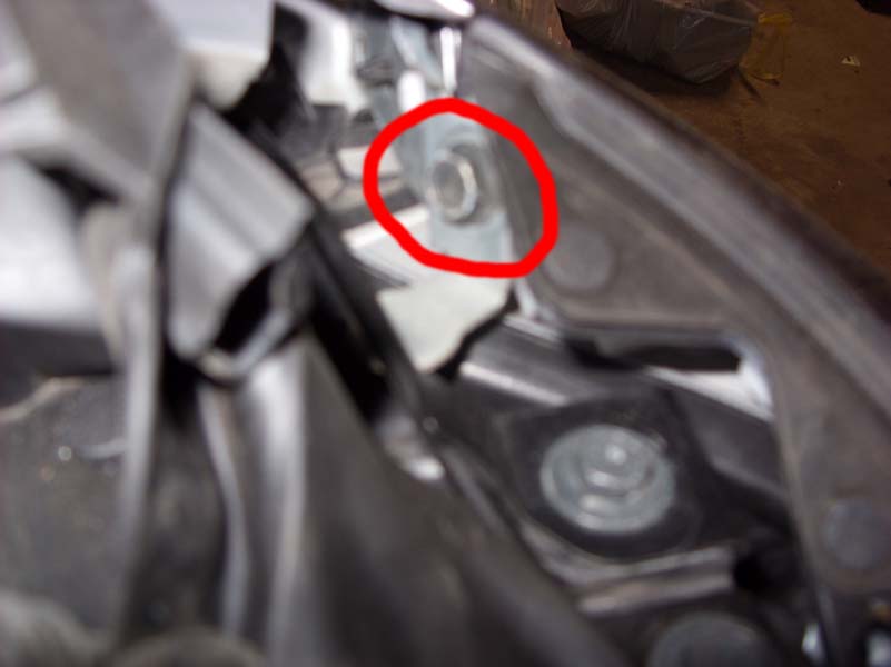

In addition to the parts we picked up, the ISIS kit came with the oil cooler, 2 AN-8 oil lines, the oil filter sandwich plate, 2 different sandwich plate adapters (for 2 different threads), and 2 18×1.5 MM fittings. To begin the install, jack up the front of the vehicle and take off both front wheels. Remove the undertray as if you were doing an oil change. Remove both fender liners by removing 5 10mm bolts and 7 clips on each one. Once the fender liners are removed, you will see a 10 mm bolt that holds the corner of the front fascia onto the fender. Remove this bolt on both sides as well.

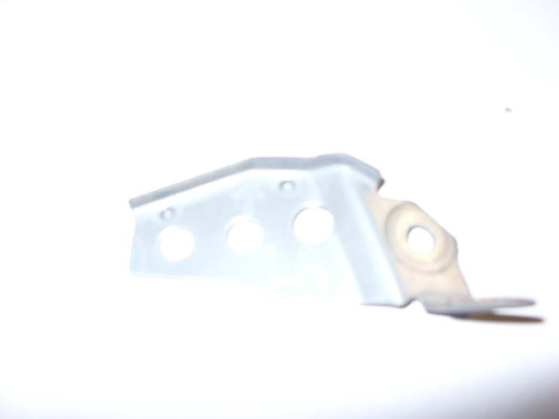

Remove all the clips on the top of the fascia. Next pull back the rubber weatherstripping above the headlights. There is a 10 mm bolt behind each side that holds a metal bracket on, which holds the top of the front fascia on.

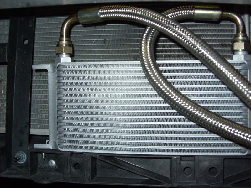

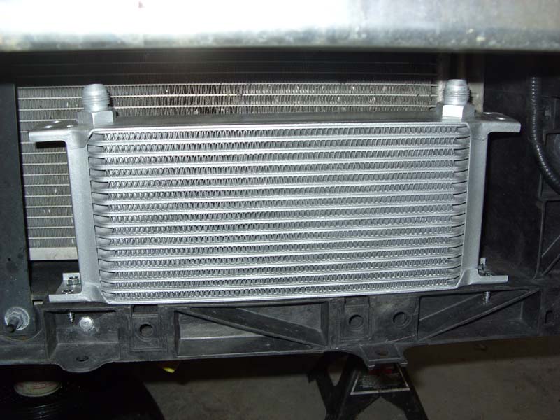

Remove the brackets from each side and remove the front fascia. With the fascia removed, use 4 self-tapping screws and secure the oil cooler to the core support in front of the radiator.

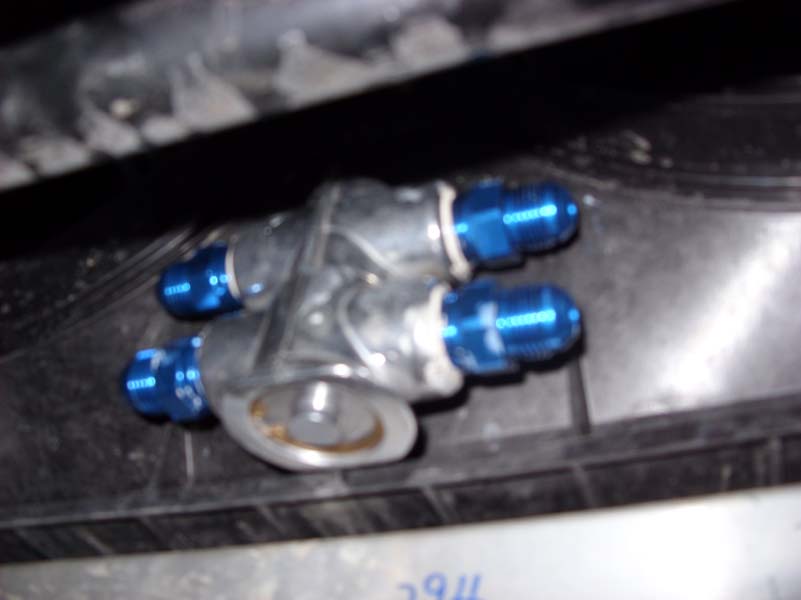

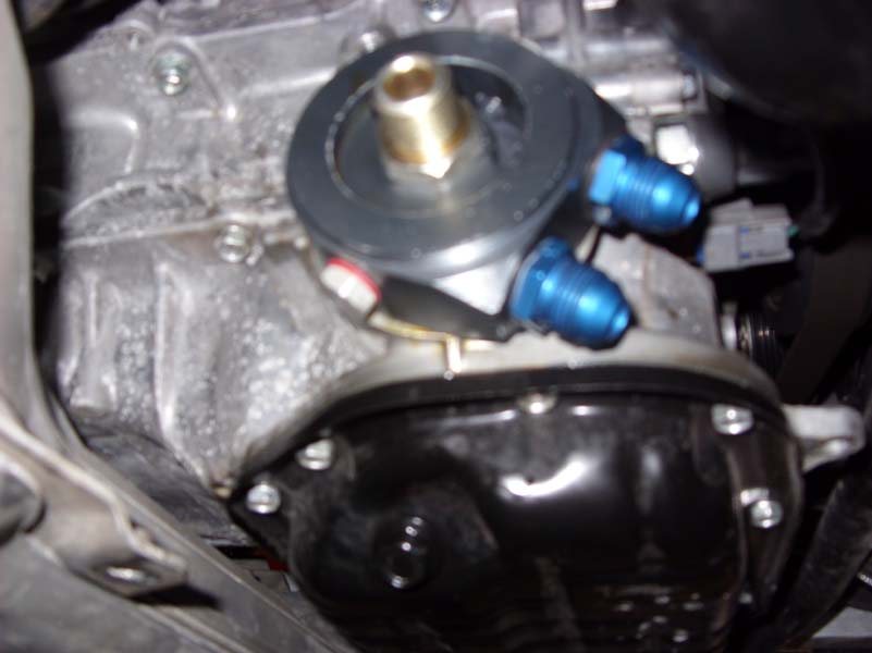

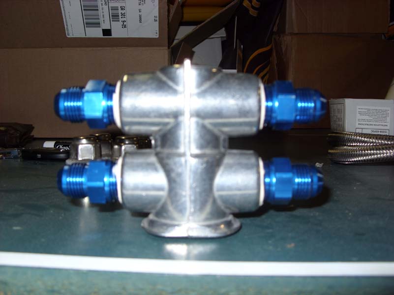

The kit comes with 2 18×1.5 MM adapters, however we chose to replace them with better quality anodized fittings. Screw the fittings into the adapter plate, and use the gold adapter plate fitting to secure the sandwich plate to the block. Next, apply thread sealant to the 4 AN-8 fittings and screw them into the thermostat.

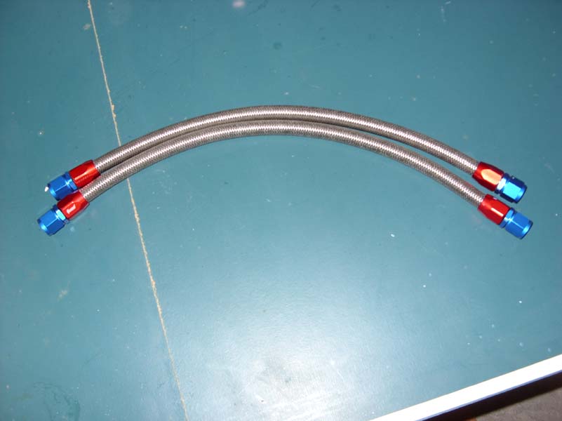

Use 2 self tapping screws and secure the thermostat to the lower radiator shroud. Using the 3 ft section of hose and 4 hose ends, create 2 1.5′ oil lines.

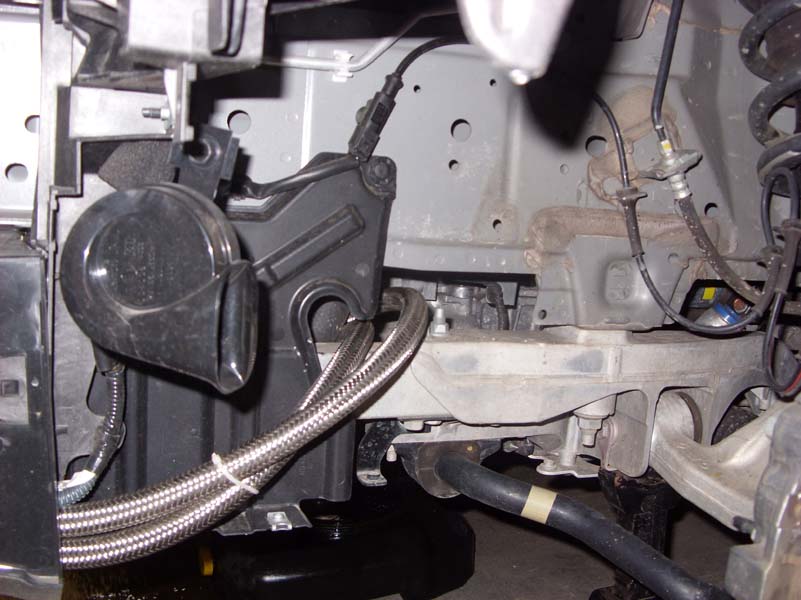

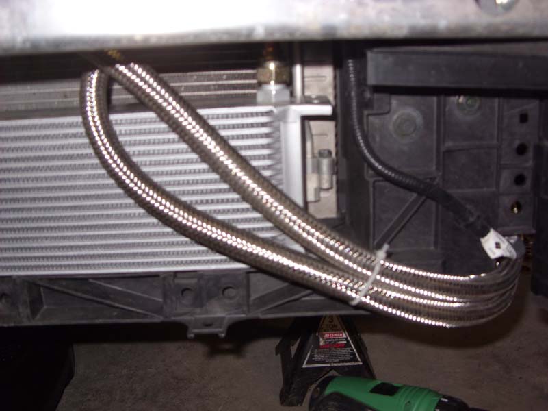

Connect the 2 new oil lines from the oil filter sandwich plate to the thermostat (make sure to locate the “hot” and “cold” side on the thermostat, it does make a difference). Next, connect the 2 supplied oil lines from the thermostat to the oil cooler. The lines can be routed above the driver side frame rail, around the corner, and to the oil cooler.

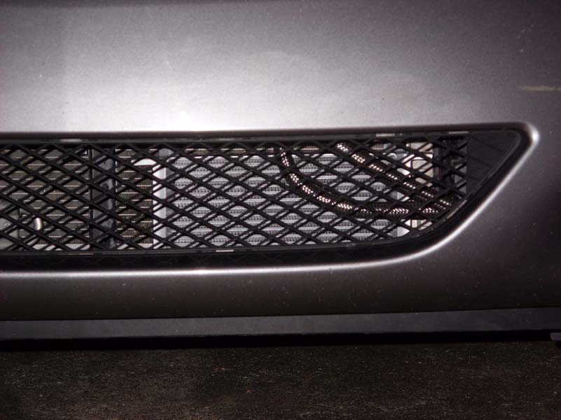

Replace the oil filter and fill the car with 6 qt of oil (1 additional qt of oil is needed because of the added capacity of the oil cooler and lines). Check for leaks, and if all is well, bolt the fascia back on. Then install the fender liners, lower undertray, and wheels. This is the completed result.
