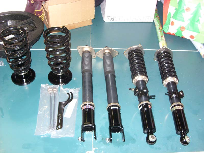

We called up BC Racing and they sent us their BR Series coilover kit for the G37. The BR series kit includes 30-way dampening adjustment as well as adjustable height suspension in both front and rear. BC Racing also offers their ERSeries suspension for the G37 as well. The ER Series utilizes remote reservoir shocks and a twin piston design. The ER Series also allows for independent adjustments for compression and rebound for even more tuning ability.

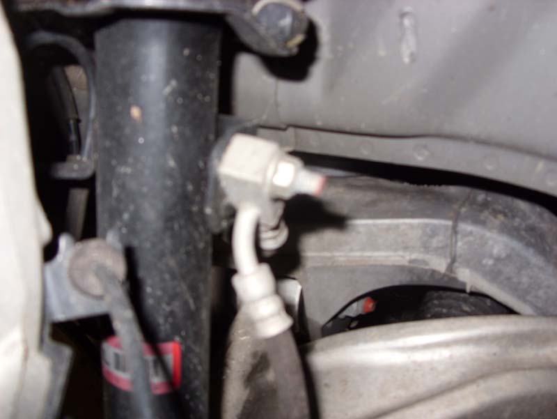

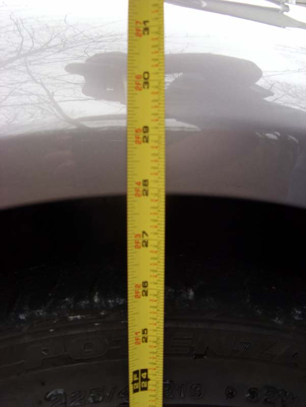

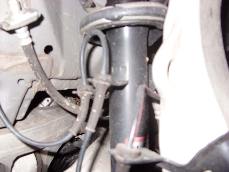

Before we began the install of the coilovers, we wanted to measure the stock ride height so that we could insure that the car was lowered evenly after the kit is installed. Measuring from the ground to the top of each wheelwell, we found the front of the car to be 1” higher than the rear.Our first step is to jack up the front of the car and remove the wheels.You will see the brake lines as well as ABS sensors attached to the front shocks. Unbolt the brake lines and remove the ABS sensors from the shock.

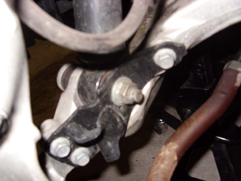

The bottom of the shock is held onto the lower A-arm with a bracket. You will need to remove the nut from the bolt that passes through the eyehole of the shock, and also remove the bracket from the A-arm. The bottom of the shock should now be loose. Looking under the hood, on top of the shock tower, you will see the 3 nuts hold the top of the shock to the frame of the car. Remove these 3 nuts while holding on to the shock below to prevent it from falling. Once these nuts are removed, you can remove the shock assembly.

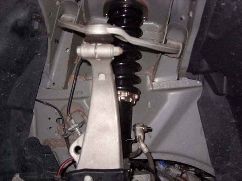

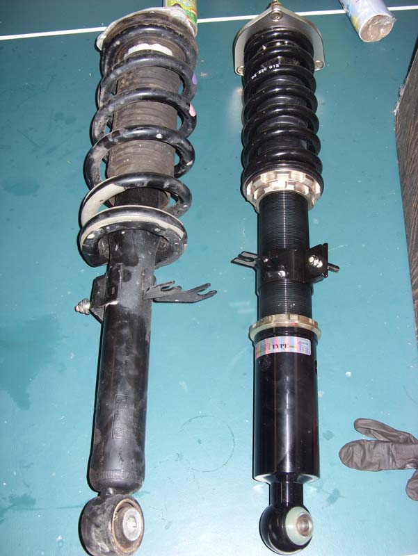

Comparing the new shock assembly to the old shock assembly,you can easily see that the new shock and spring are a much more compact design. The new shock can also be adjusted to be exactly the same length as the old one, which will allow you to keep the exact same ride height as before, if that’s what you desire. Install the new shocks by sliding them up through the shock tower and screwing on the 3 nuts to the top of the shock. Loosen the brake line bracket from the shock and spin it so that the brake line can be attached at the same angle it was removed. Push the ABS sensor line into the bracket on the new shock. Then bolt the bottom of the shock to the A-arm and reinstall the bracket that holds it in place.The finished result should look just like the original shock assembly did when it was on the car.

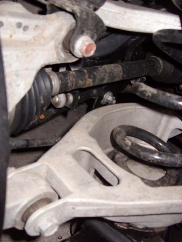

Likewise with the front, jack up the rear of the car and remove both wheels. At the bottom of the rearhub assembly, you will see a nut and bolt that passes through the spring perch. Remove the nut and bolt and allow the spring perch to drop down, loosening the spring. Push the perch down enough so that you can remove the spring.

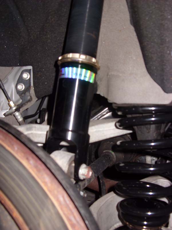

The new spring includes an adjustable support that allows you to adjust the height of the vehicle by effectively altering the length of the spring. Install the new spring and height adjuster onto the spring perch. To lift the perch back up so that it can be tightened, use a floor jack to jack it up until you can get the bolt back through the mounting point on the lower part of the wheel hub.
Next, remove the bolt from the upper part of the wheelhub that holds the bottom of the shock on. Remove the two nuts on the top of the shock that hold it to the shock tower. The shock can now be removed.

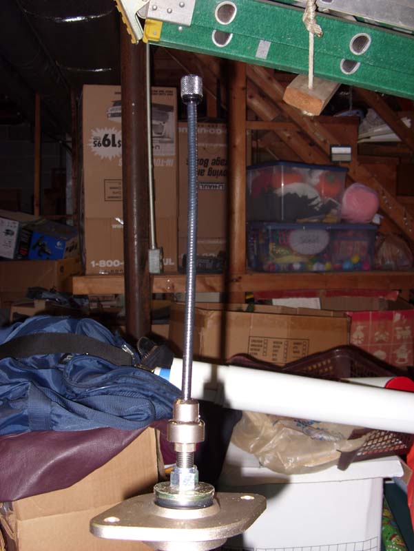

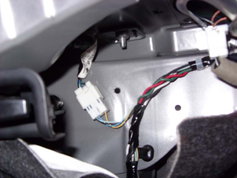

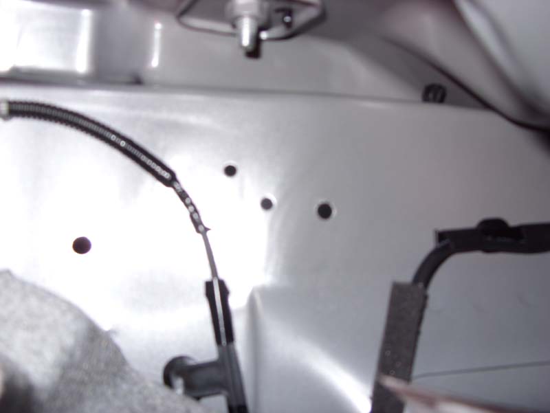

Before installing the rear shocks, you must first make a way to adjust them. The kit comes with two adjusters for the rear shocks. Begin by opening the trunk and removing the carpeting. There are numerous plastic push-snaps that hold the carpeting in. Once the carpeting is removed, you will see a white electrical connector on the left side of the trunk. This connector lies on the shock tower. Drill a hole next to it large enough for the cable of the shock adjuster to fit through it.

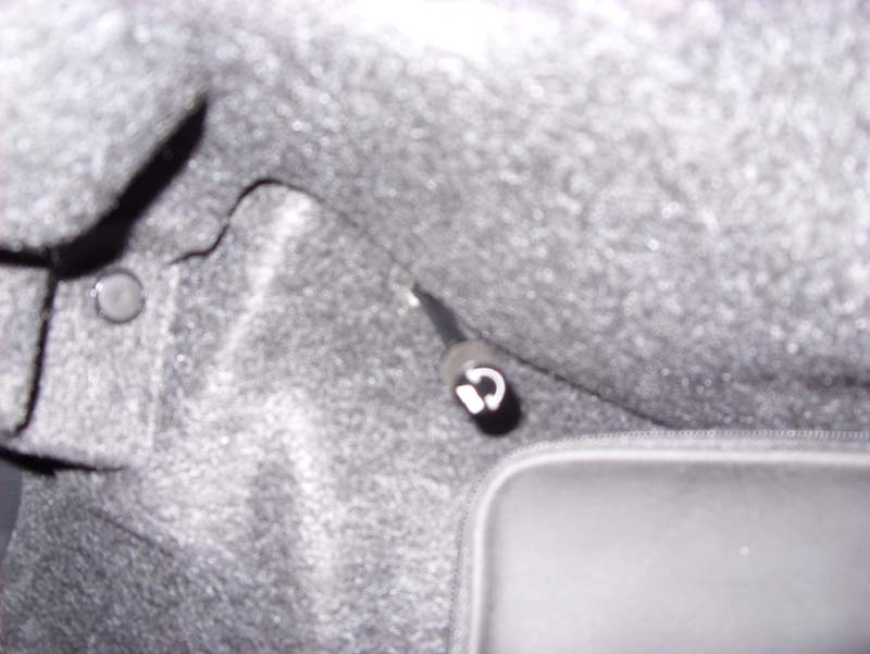

Next you can install the left rear shock. Attach the adjuster to the top and tighten the set screw. Then remove the thumb knob from the adjuster. As you lift the shock into place, guide the adjuster cable up through the shock tower and feed it through the hole you drilled in the trunk. Once the shock is in place with the adjuster cable poking through to the trunk, install the two nuts at the top of the shock and re-attach the bottom of the shock to the wheel hub.
For the right side of the vehicle, follow the same procedure as the left. When it is time to drill a hole through the shock tower, compare the hold drilled on the left side and estimate where to drill on the right. Then, like with the left side, install the shock while guiding the adjuster cable up and through the newly drilled hole. After both shocks have been mounted and are secure, begin to place the trunk carpet back. Drill a hole through the carpet on each side so that the adjuster cables can come through, and re-secure all the carpet fasteners. Finally, re-install the thumb knobs onto the adjusters and tighten the set screws.
After the rear shocks have been installed, re-install both rear wheels and lower the car. Roll the car a few feet (or drive it) to allow the suspension to settle and re-measure the ride height.

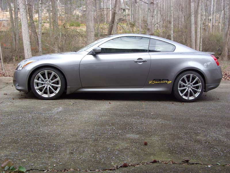

We found that when the kit was installed without any ride height adjustments made, the car was almost exactly the same height as when we started. Like we mentioned before, the front of the car measured 1” higher than the rear. To give the car a much cleaner stance without compromising much ground clearance, we chose to lower the front of the car 1” to match the rear. We left the rear the stock height.

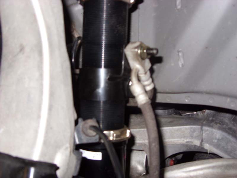

To lower the vehicle in the front, jack up the car and remove the wheels again. Use the supplied adjustment wrenches from BC Racing and loosen the lower adjustment lock. Do not loosen the upper adjustment lock because this will change the spring tension. The BC Racing coilovers can lower the vehicle and maintain the same spring rate by screwing the threaded portion of the shock down into the lower shock body. Measure the amount you wish to lower the car on the threads before adjusting it. Screw the shock into the lower shock body the desired distance, then re-tighten the adjustment lockring. You will need to loosen the brake line bracket from the shock so that you can turn the shock assembly as you thread it into the lower shock body. Once the shock is adjusted to the desired point and tightened, tighten the brake line bracket and re-install the wheel. Do the same for both sides and re-measure your ride height.
