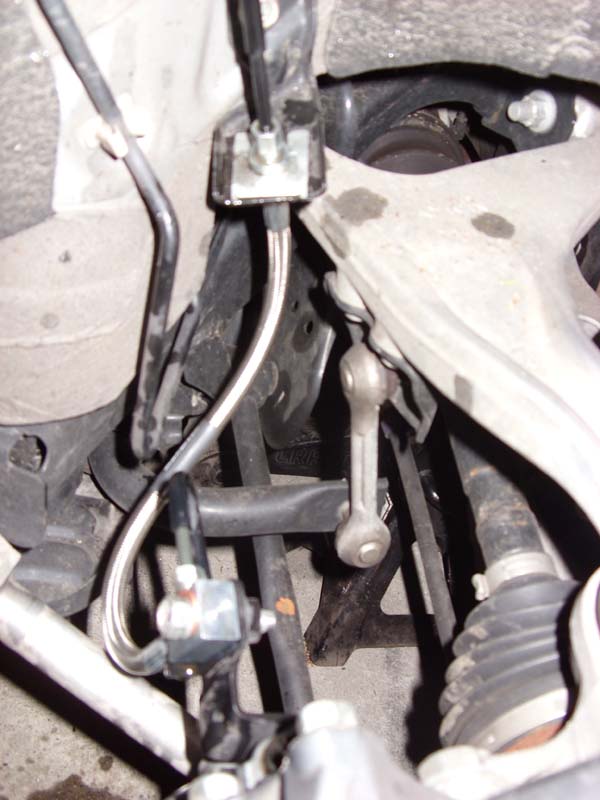

In addition to the new brake pads, we also chose to upgrade the brake lines. For these, we contacted G-Spec Performance. They didn’t have anything for us at the time, so we worked with them on a solution. After a few test fitments, they had some stainless steel braided brake lines developed just for us. By switching to braided steel lines from the stock rubber lines, this will maintain consistent brake pedal pressure. Because the steel lines do not expand like the stock rubber ones do, you don’t have the wasted pressure of expanding the rubber, and instead increased pressure on the pad. G-Spec Performance now sells this brake line kit, so if you’re using our Project G37 as a guide to build your own G, you too can get these brake lines here.

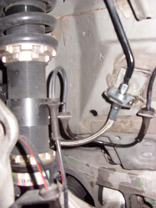

The rear brake lines have one block end fitting just like the stock ones do. Simply remove the hard line going into the block, unbolt the block from the mounting bracket, and unscrew the line from the chassis-side hard line. Remove the mounting clip and remove the line. The new lines come with new clips but you will need to re-use the bolt that holds the block onto the bracket.

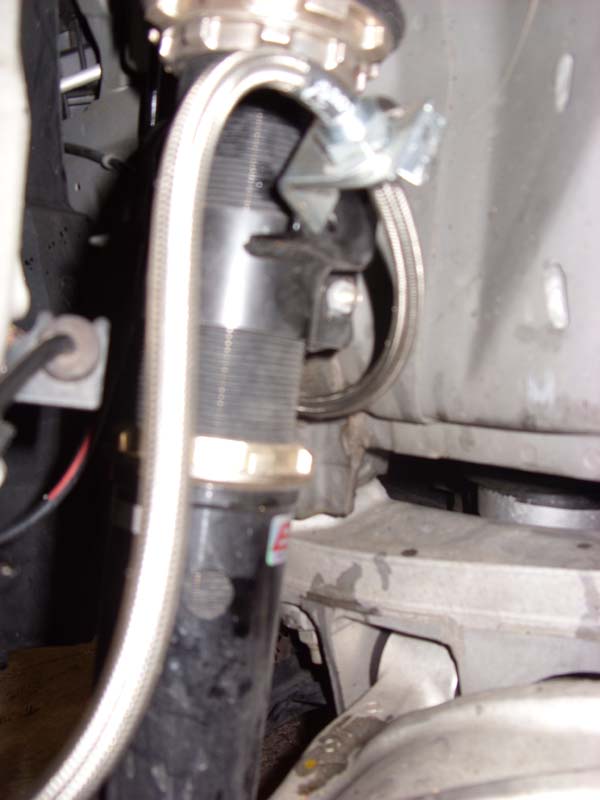

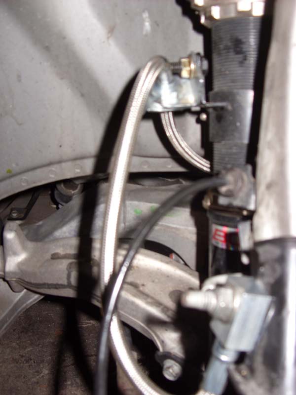

For the front lines, the stock lines have two blocks. The first is mounted onto a bracket on the shock, while the second is on the caliper. Remove both sections of the soft line. The new brake lines come with a pair of mounting brackets for the front lines. Using the original nut, screw a mounting bracket onto the stock mounting point on the shock. Connect the new line at the block end to the caliper hard line, run the new line through the installed mounting bracket, then attach the other end to the chassis-side hard line. Use the stock mounting nut to secure the block to the caliper, and use the provided clips to secure the middle of the line to the installed mounting bracket, and the other end of the line to the chassis.
