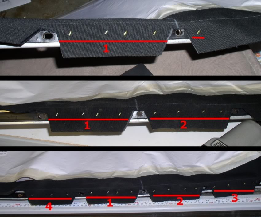

The FSM says to go ahead and use your old top to mark out the areas to cut out for the studs to pass through for when you bolt the tack strip back in place. I find it easier to not do it do it during prep. What I do is cut out the center cutout and put two staples in on each side to hold the drape to the tack strip. Then work my way out. I hold the cloth down taught against the tack strip and mark my next cutout and make my cuts. Then I staple the cloth down between the cutouts. Then I jump to the other side and do the same thing. Mark->cut->staple. And I keep working towards the outside alternating sides as I go. This will help you keep the rear window stretched against the tack strip and should hopefully keep wrinkles out of it.
top31
You can see where I stapled my initial holding staples down and then worked my way out on one side (1). Then in the second picture, I have worked out towards 2. Then I cut out and work out towards 3, then 4 so on and so forth.
