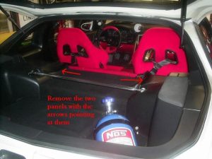

Since searching around on the internet revealed this is becoming a more common problem as the 300zx ages, I figured I’d address it. If you have the symptom that you turn your key off and remove it and your Z won’t shut off, it is most likely your fuel controller. Removal and replacement is simple […]
