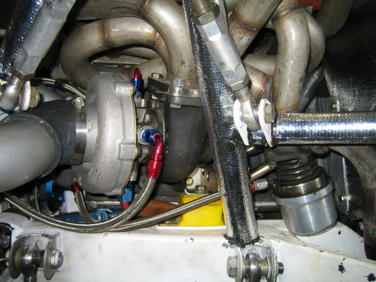

Eventually after a lot head of scratching, temporary fabricating, bad language, frustration and calls to Don Preston, I got the car to the point that I thought we could get it running and drivable again; but nothing fit the SCCA modified chassis. No one would even attempt to build the headers locally because of how restricted the space had become because we modified the car from McPherson struts to unequal length A arms for SCCA.

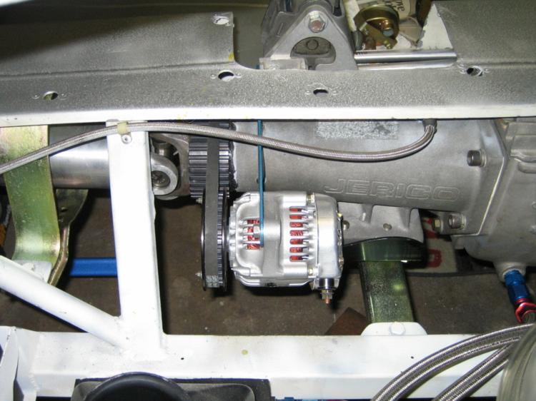

And, I had specified 29 inch tube length based on Burns Stainless Steel engine computer program recommendations and to reduce the lag as much as possible. The upper control arm support tubing that EJ had installed was just in the way. Turns out the special design and fabricated cantilevered McPherson strut suspension left a very large open space for the turbocharger and headers on the driver’s side of the car. I cut the car up enough to accommodate the original headers and a new ATS turbo and had Don Preston build an extended bell housing adapter (11-12 inches) to mount the Jerico ultra-close ratio 4-speed to the engine and got it about were I wanted it to end up. No front suspension upper pick up points on the drivers side existed now. I had to find a fabricator to continue with the major modifications. I had always intended to do the hydraulics, oil line plumbing, water piping and wiring myself. The alternator is driven off a custom built drive shaft pulley (see below):
200sx alternator driveshaft

Note the 29 inch SS headers (spaghetti, anyone?) and the ATS turbo.
200sx turbocharger L20B
