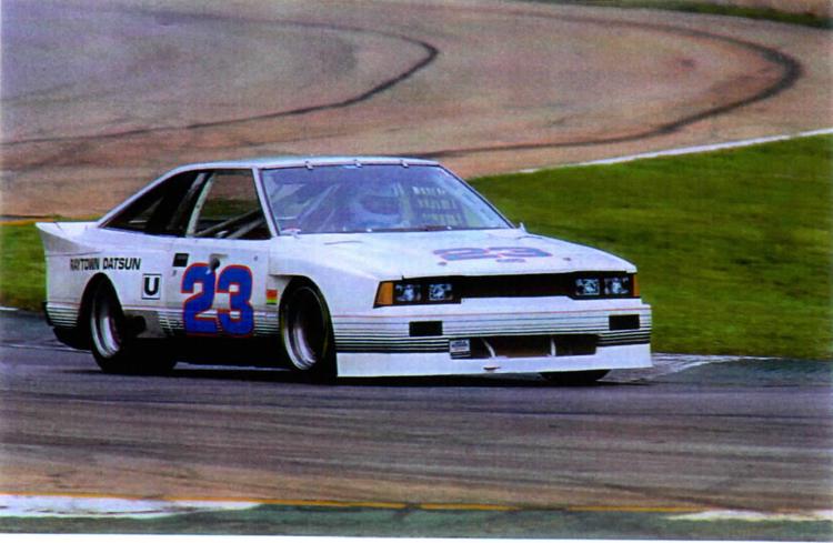

We fought several problems with the car mainly concentrated around head gasket sealing. This engine used a special pressurized stainless steel doughnut sealing ring recessed into the top of the block and a separate fabric gasket. I ran the first engine as it had arrived assembled from Mike. It worked very well. The engine was very responsive and seemed reliable.
200sx IMSA car at Daytona

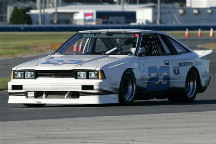

But the gremlins from the past showed up at Daytona in turn 2 at around 120 MPH; the wastegate failed and instantly smoked the tires, turning the car sideways. Out of the corner of my eye I could see the boost going past 40 psi! I am sure the engine instantly made well over 500 HP; hence the tire spin. Bottom line, I smoked the wastegate diaphragm and resulted in a blown head gasket.
I rebuilt the second engine, which came with the head removed and things went south. We had a lot of trouble with head gasket sealing and with the supply of these special sealing ring parts waning, we abandoned that design, sleeved the blocks and O-ringed them with a custom Cometic gasket that has worked well. Over the next several years we went to HSR events not to compete but to drive the car, continue tuning the injection and staying out of everybody’s way.
200sx at the HSR Mitty:
The car was very fast as is shown in the video below. We calculated the car ran well over 170 MPH on the front straight at 8000+ RPM and I lifted because the car felt a little odd coming out of Turn 4 at that speed. Later we found out that the rear tires were rubbing against the body upper fender wells because the car was generating enough downforce at top speed to compress the springs. We later put bump stops on the shocks to reduce suspension travel.
Daytona International Speedway, November 2008
