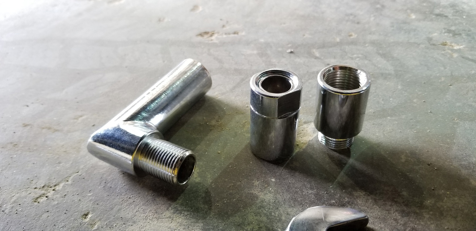

After doing all of these checks and reading a few other successful attempts at this, I decided that maybe the best strategy at this time is to “trick” the downstream oxygen sensors into thinking everything was fine. These sensors are only in place to tell the ones in front of them that everything is fine after this set of catalytic convertors, so if they think everything is fine then the error code should go away. So I purchased two sets of oxygen sensor spacers and decided to give it a try.

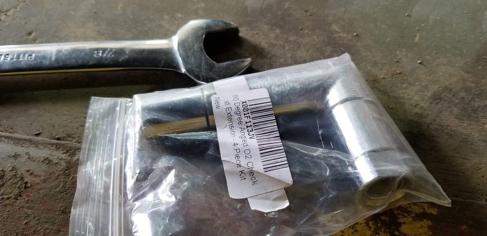

These are the ones I purchased from Amazon: 90 Degree Angled O2 Check Engine Light CEL Fix Oxygen Spacer Exhaust Extension – 4 Piece Kit

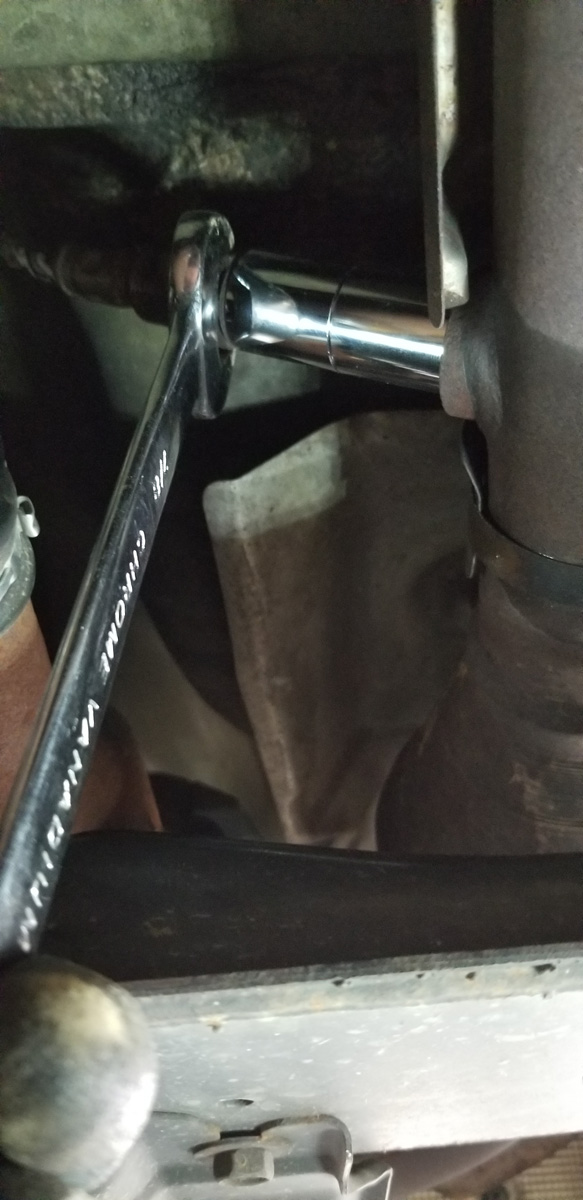

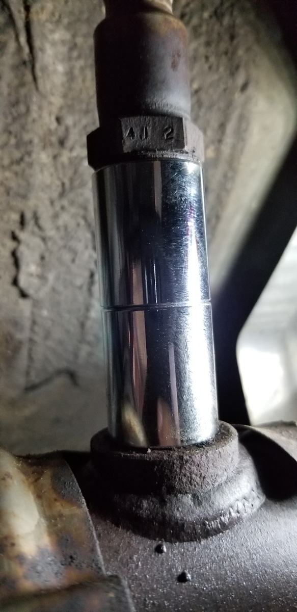

Once I received them, they were a very simple install. I had a pit to work underneath the vehicle, which made it even easier, but this could be done with the vehicle safely elevated with ramps or lifted with a jack and jack stands. Once underneath the vehicle, you will find them right around the front doors inside of the frame where the exhausts comes off of each side of the engine, before it goes into the y-pipe and turns into a single exhaust.
Once you have located them you will need a 7/8″ Wrench or 7/8″ Oxygen Sensor socket if you prefer. The wrench worked just fine for me and there was plenty of space to work with in this area. Remove each sensor from the bung on each side, then use the two straight adapters included in each pack and screw them together(you want two on each side). Now screw them into the bung that the oxygen sensor was in, then screw the oxygen sensor into the spacer on each side and tighten everything down using the oxygen sensor.
