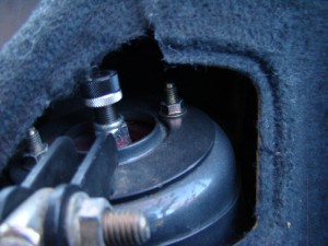

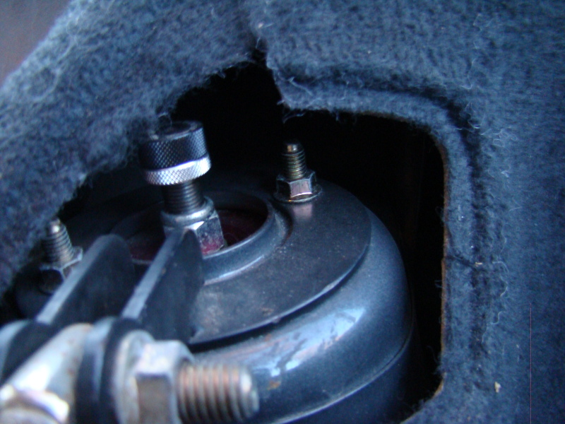

Note the slight surface rust on the silver parts.

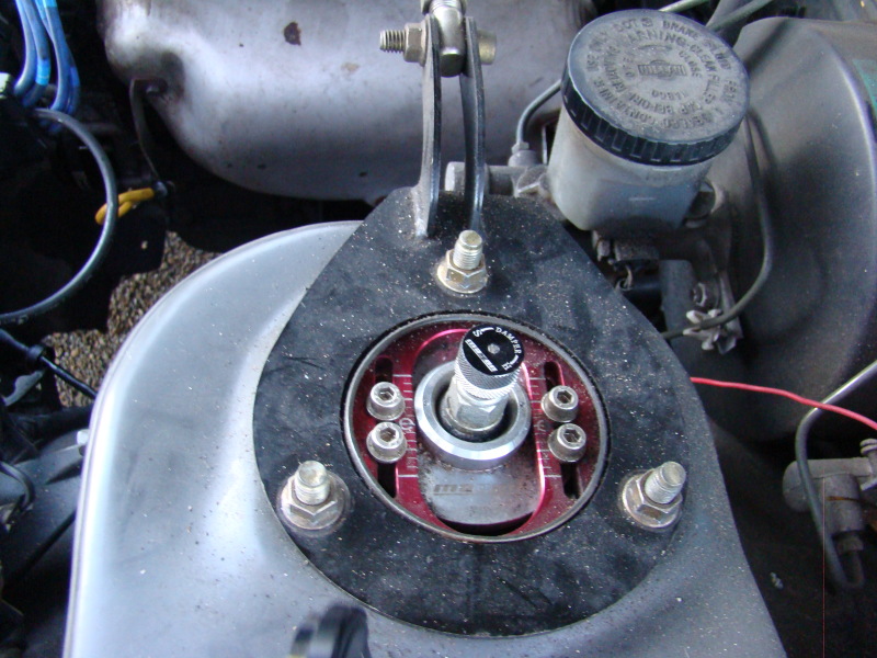

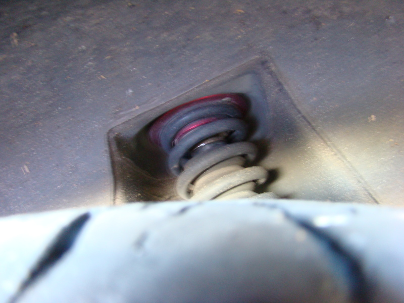

dirty inside the wheel well. Dust covers still in good shape. Everything tight and crack free.

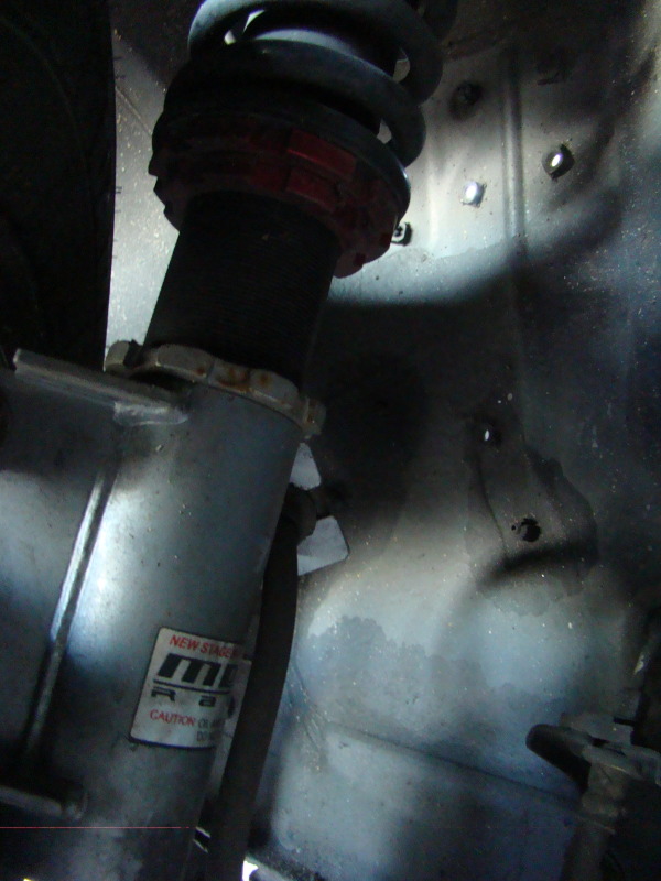

And the slight surface rust on the ride height adjust bolt
