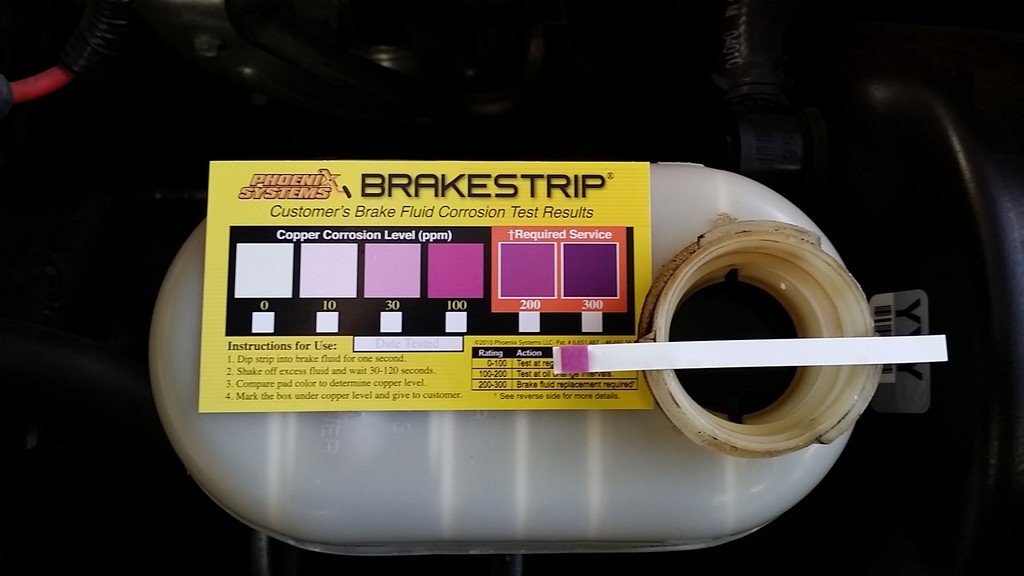

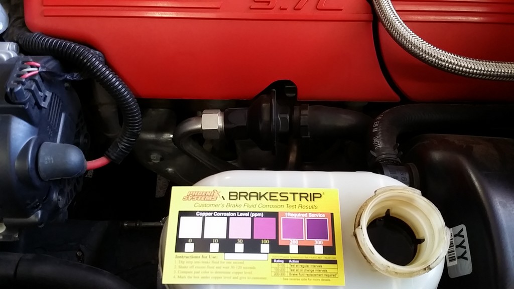

The first thing we’re going to do is to test the existing fluid. The revolutionary BrakeStrip brake fluid testing system guarantees fast, accurate results.
Simple process – Remove the master cylinder cap and dip the strip for one second, then wait 60 seconds and read the results.
Now, this fluid has been in the car for two years… I know, because we flushed it ourselves when we upgraded the brakes. The dark color consists of numerous contaminants, including seal material (suspended rubber molecules), as well as corrosion from inside the metal lines. Remember, brake fluid is hygroscopic, which means it absorbs moisture from the air. This allows corrosion in the lines (and inside that expensive ABS pump), and it also affects the fluid’s boiling point, meaning your brakes can underperform or fail under severe use.
Clearly, it’s failed our test… which is great, because we’re flushing it!

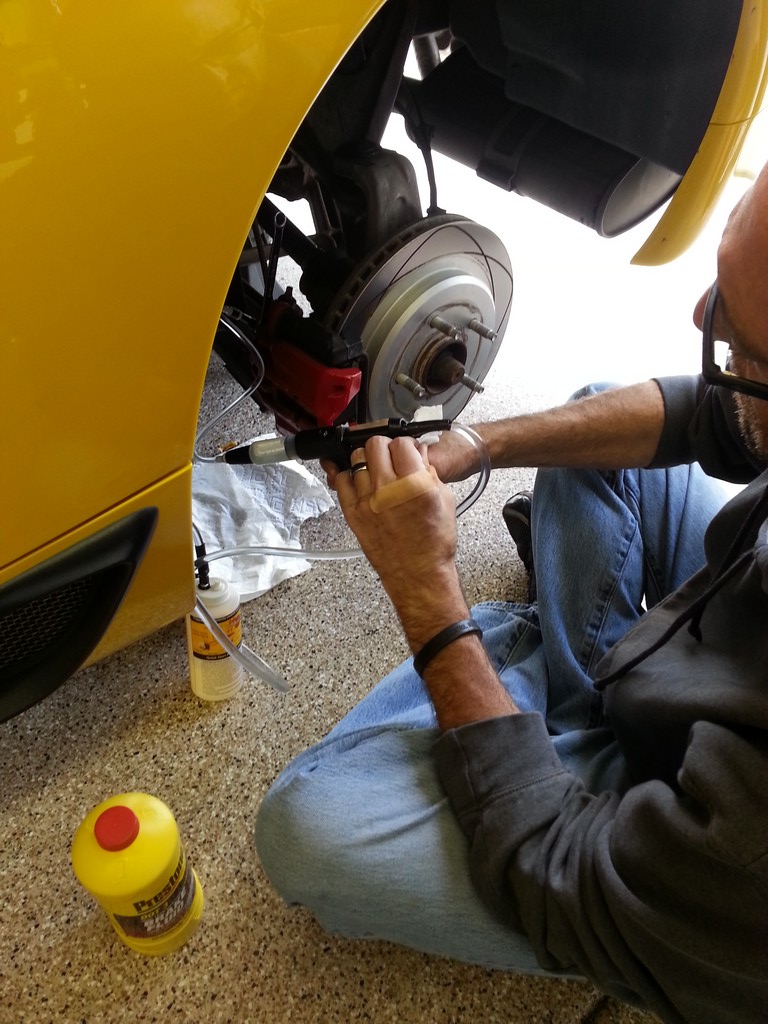

The rest of the task is relatively simple. With the car on 4 jackstands and all four wheels off, we assembled the V12 bleeder to reverse-bleed the brakes. This means we’re going to be pushing fluid from each caliper, UP to the master cylinder. With the nose of the car slightly higher than the rear, this allows us to get ALL of the air out of the lines (as well as all the old fluid).
Using the Professional V-12 was super-easy. No drips, no leaks, and ONE person can do the whole job.
Speaking of which, some of you are probably thinking, “Yeah, but I got a buddy to pump the pedal, I crack the bleeder, wait for the fluid to squirt out, close the bleeder, and I’m done.” That’s nifty – but you’re doing it wrong.
That method takes the internal components of the master cylinder FAR outside the normal “stroke” range, which is a very good way to tear a seal. It also doesn’t allow all trapped air to exit the system, as the bleeder threads themselves are often a key leaking point. Lastly, unless you’re going to do a LOT of stroking and pumping, you’re just pushing the contaminants down into your calipers – which aren’t cheap to replace.
Starting at the farthest wheel from the master cylinder, and working my way forward (RR / LR / RF / LF), the actual bleeding process took about 10 minutes. About four strokes of the trigger per corner pushed dirty fluid up into the reservoir (where we could suck it out easily) until the fluid came up clear.
On the fourth corner, it was really cool to see the master cylinder fill up with pristine, clear fluid.
