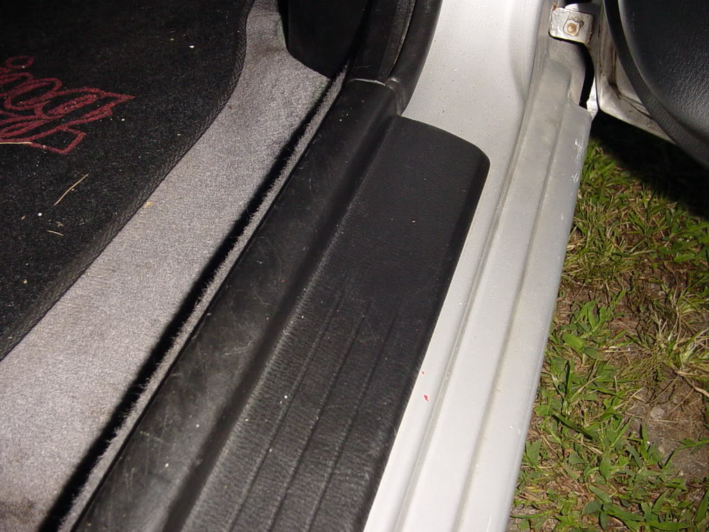

1. Remove or loosen the door sill. simply pry up and it will come free

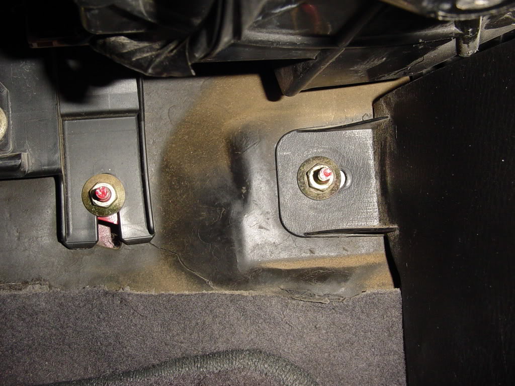

2. Next, remove the nut to left

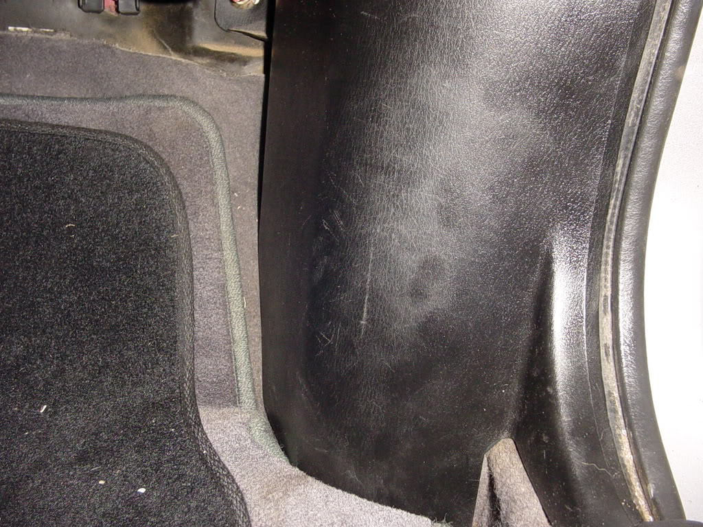

3. Simply pull the kick panel out of the way

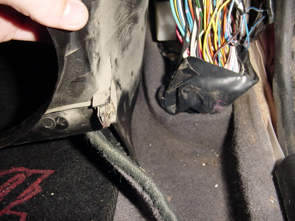

4. Now you have access to the ecu

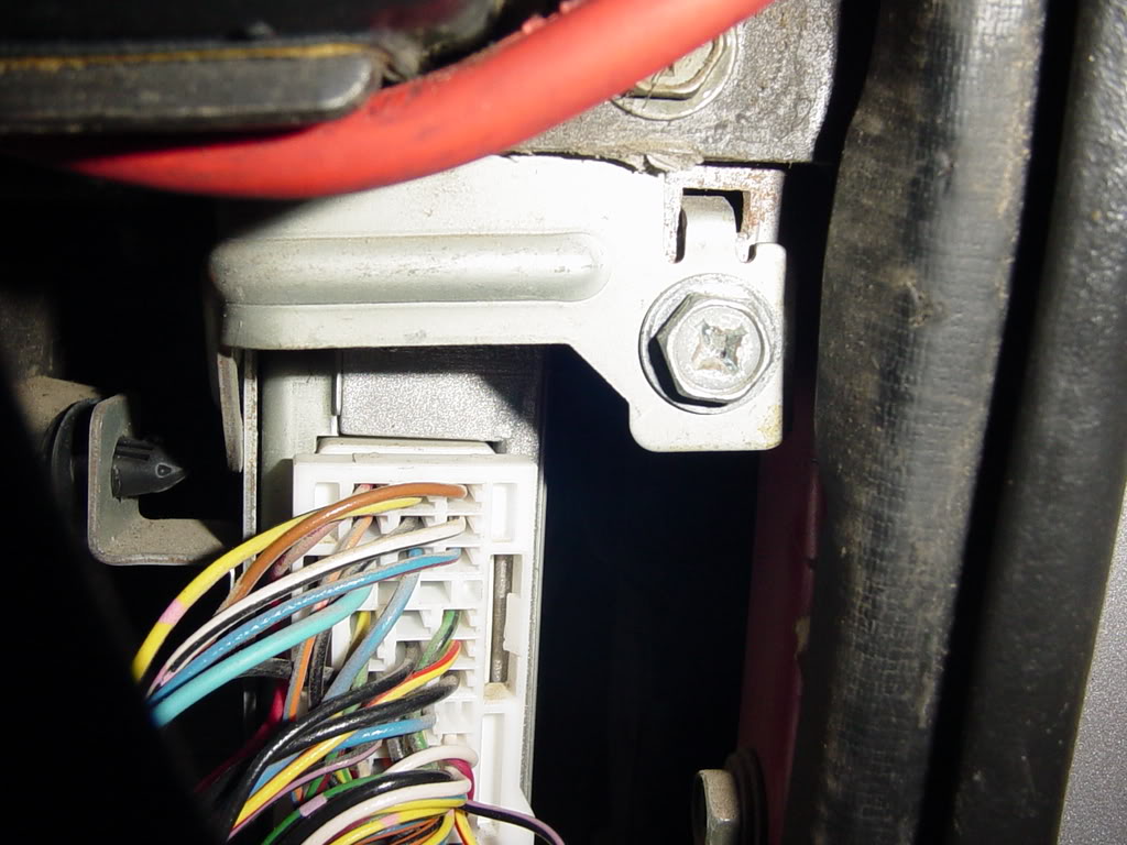

5. Undo the bolt in the center to unplug the connector
6. Now undo this bolt on the bracket

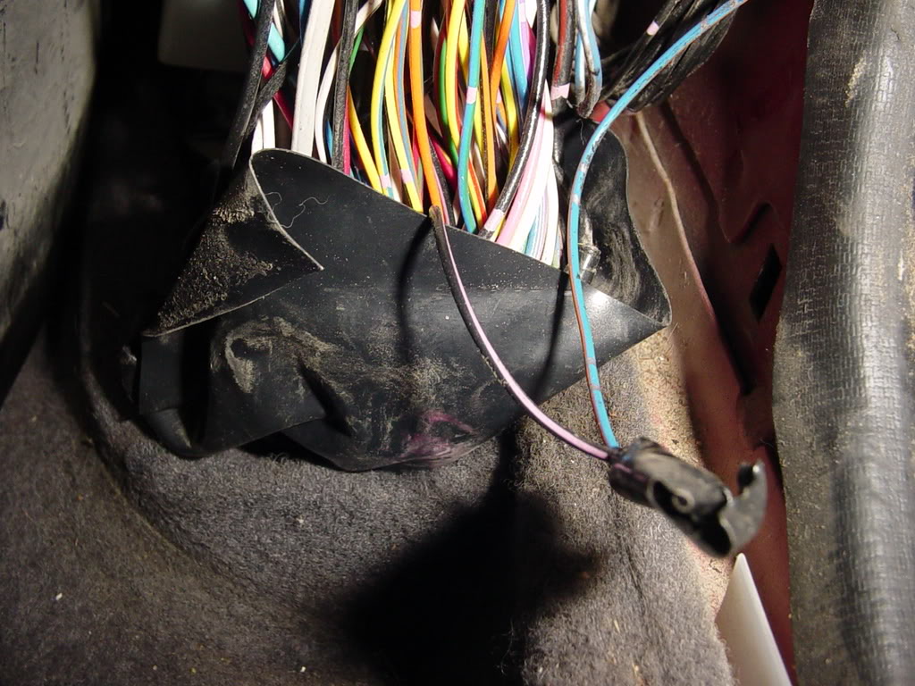

8. To do your cut off switch you need to expose the wires. Cut away the black loom like so
9. Now, the wire you are looking for is the black wire with a purple stripe. NOTE* their are two black and purple wires* the one you want is the one by the the ecu connector bolt
10. Just cut splice in your switch, and your done.
