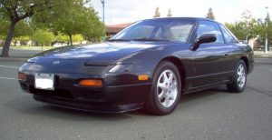

I know this is an old trick but I was so proud of my $15 lip I just had to post it! I put it on the other day and I think it looks pretty good.
Its no PDM lip but it also doesnt make me cringe every time enter a high angle driveway or hit a dip in the freeway at 80 mph.
I paid $10 for a whole 20ft roll (comes in a box) of baseboard molding in the “office supplies dept” of Home Depot.
Then $5 for a box of the wide head autobody screws from AutoZone. The wide head screws dont leave the dimple effect if you refrain from over tightening.
