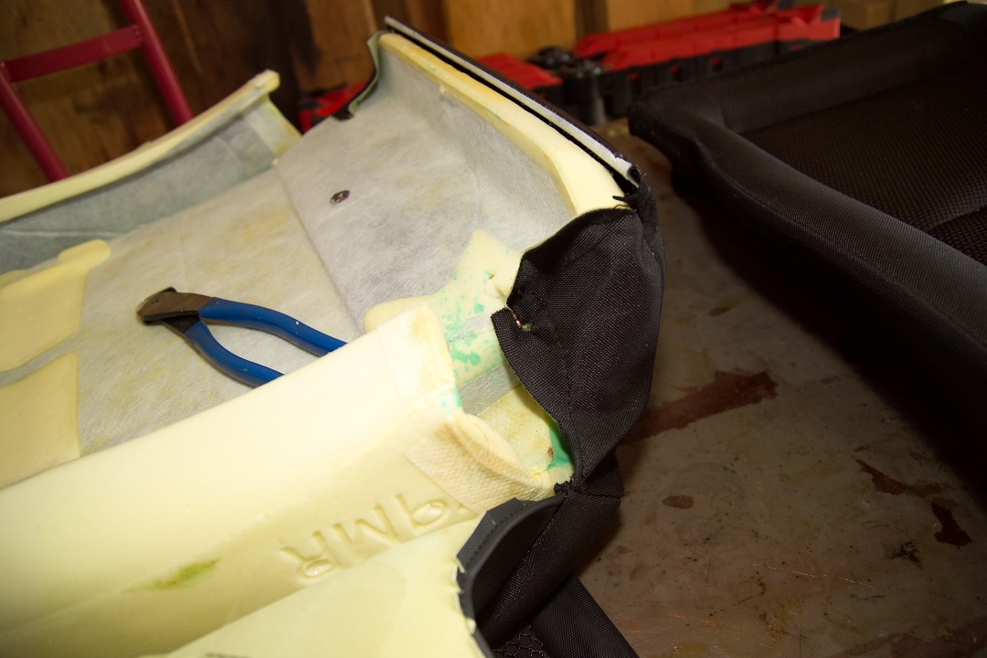

Cover/cushion separation: Place the bottom cushion on the work bench, face down. Using diagonal cutters snip the hog rings and remove the pieces (NOTE: Put on your safety glasses, the hog ring chunks WILL go flying!) Flip the cushion over and fold back the sides of the cover. Observe that the seat cushions have side bolsters and the contour of the seat is maintained by wire stays embedded in the foam rubber. The cover is held in place to the stays with hog rings. Locate the hog rings and snip them to separate the cover.

At this time it is a good idea to inspect the cushions for tears. My driver’s seat bottom cushion was torn on the door side bolster where you slide your butt getting in or out of the car. Repair was accomplished with the 3M adhesive using pins to hold things in place while the adhesive dried. After the inner layer of adhesive was dry, I applied a second coat on top to help spread out seating stresses and prevent future damage.
