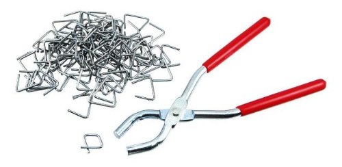

Tools and Supplies Required: Besides the usual shop tools, you will need a pair of hog ring pliers and a supply of rings. These can be purchased at a Tractor Supply or Ace Hardware. You may also want some 4” cable ties. If you are going to use cable ties, you may want a pair of forceps from Harbor Freight to help dress the ties in close quarters. You may also need some 3M Yellow Super Weatherstrip and Gasket Adhesive to repair any damage you find in the foam rubber cushions.
3M yellow weatherstrip adhesive cutting pliers hog ring pliers zip ties
