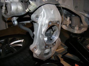

Remove 4 17mm bolts from back of wheel bearing hub assembly. You will need to turn the wheel the opposite direction to get them all

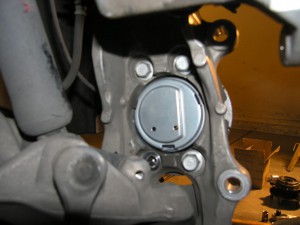

Gently work the old hub/bearing assembly out of the spindle
There is a magnetic ABS sensor inside the hub/bearing assembly that feed through the spindle. Be careful to not break this part!

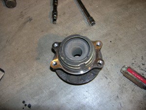

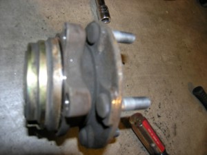

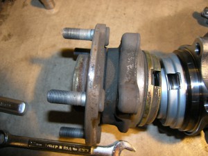

This is the old hub assembly you can see all the metallic dust coming out of the hub where the wheel bearing is failing

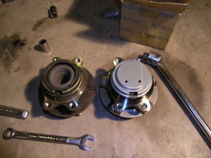

Old Vs New
