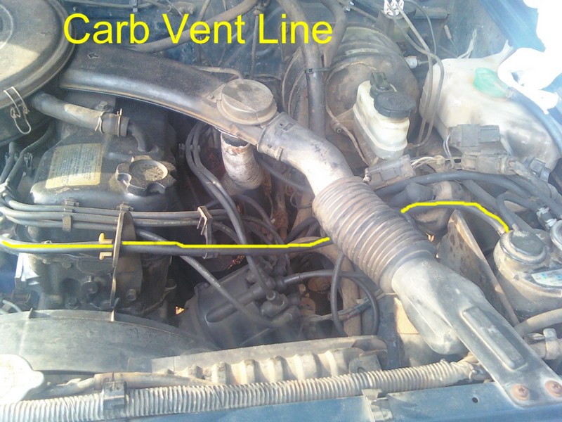

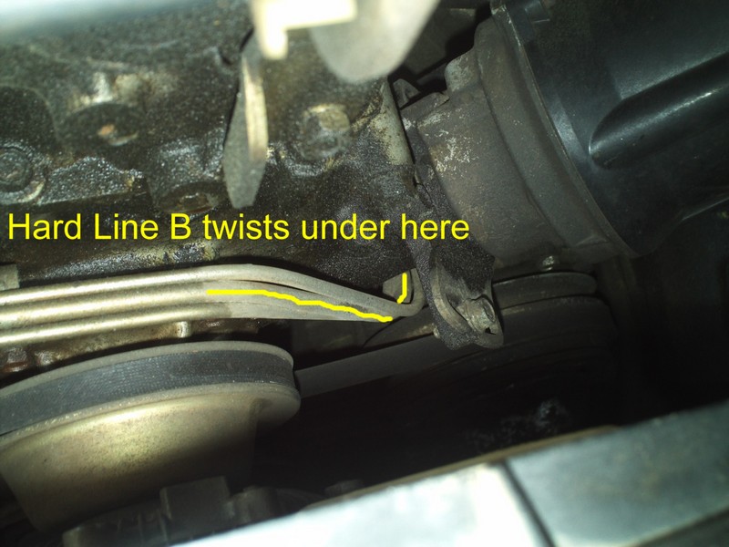

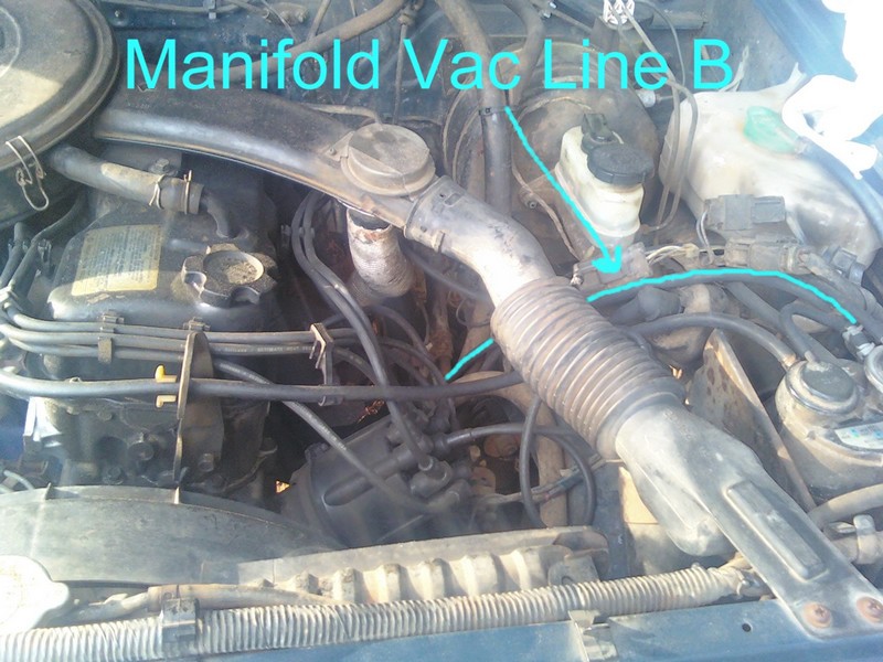

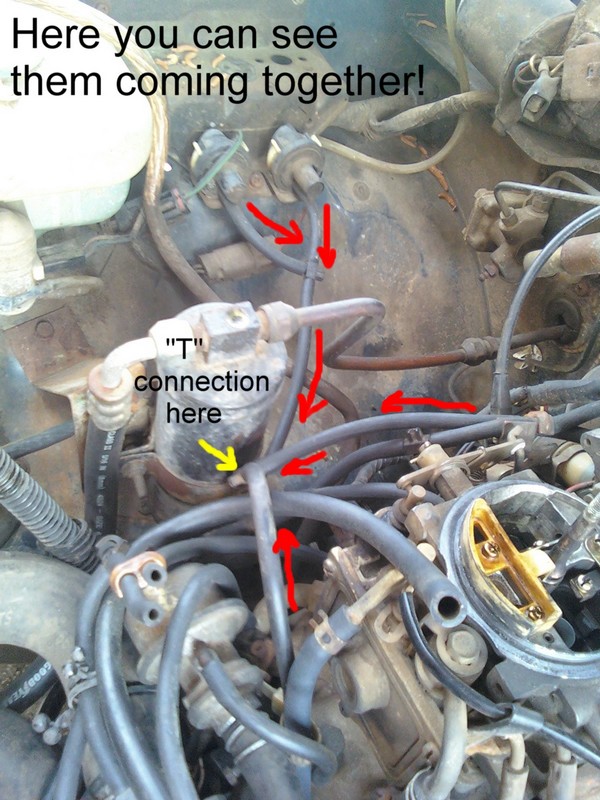

The black canister that sits under the hood just behind the driver’s side headlights has several vacuum lines coming off of it. Let’s take a look at where they go.
In Section 2, we named two of these lines A and B. We will trace them to this canister again in this section.

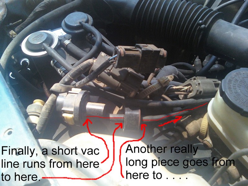

There is one more vacuum line near the vacuum canister.
