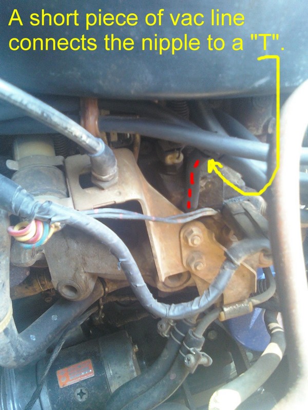

This short hose piece is difficult to see, but if it’s bad, it may cause problems.
Nissan 720 Pickup Truck Vacuum Hose Routing
There is a short vacuum nipple near the throttle bracket. A short vacuum line connects it to other lines with a “T”. Two lines come from near the firewall, which join into one line and then connect to this short line with another “T”.
