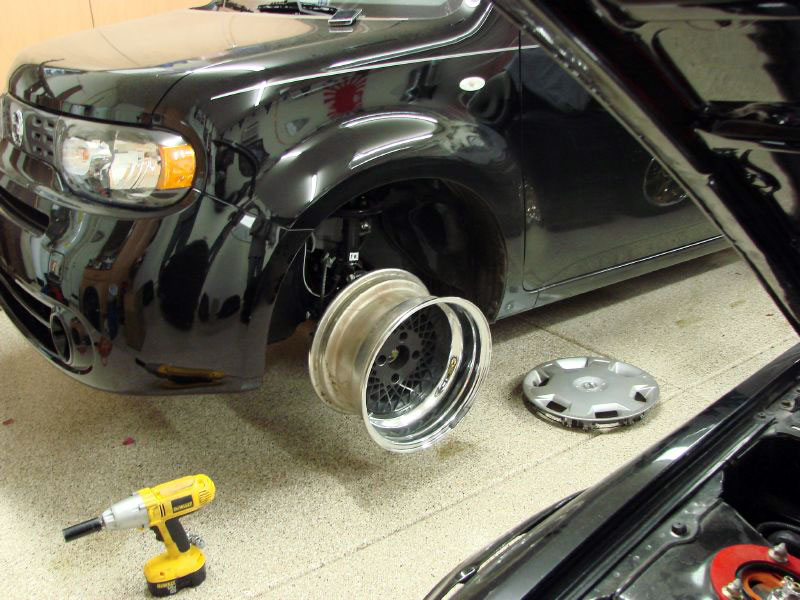

Get the front of the car in the air and supported on jack stands. No need to get it way up there, just get the front tires off the ground. Remove the front wheels and open the hood…
Just for fun, mount up a 15×9, -26 offset black mesh wheel… Wow. Think we’re gonna need some 3″ flares to run those!
(Just kidding – Those are for a different project car…) Back to work.

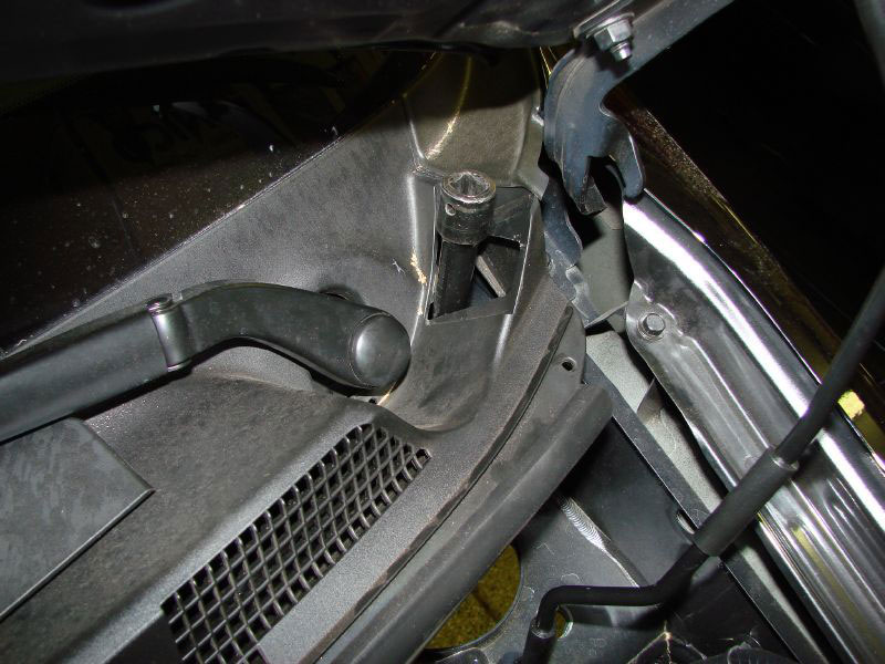

You’ll notice that only two of the strut tower bolts (under hood) are visible. Yep, that’s right – one is behind the firewall. Fortunately, Nissan built in a nifty little removable plastic cover to allow access to the third one. Pop it out with a screwdriver and use an extension on your 13mm socket.
VERY IMPORTANT: Magnetize the socket or extension with a good powerful magnet. If you drop the strut tower bolt removing it through the tiny “hatch”, you’ll never, ever find it. Yep. I did it. Oops. Fortunately, I have about forty blue million Nissan bolts, and found a replacement easily enough.

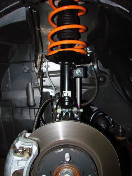

The strut is held in place by two large bolts / nuts at the bottom and those three strut tower bolts up top (under the hood), which you just removed. Before you get after the large bolts, remove the brake line retaining clip, and slide the brake sensor wire harness out of its brackets. Remove the bolt holding the sway bar arm to the strut body, then remove the two big bolts. Pull the entire strut / spring assembly out and set it aside.
Use the spring compressors and remove the top nut on the strut. Some will say “don’t use air tools” on this. Well, don’t. I did, but you shouldn’t. Remove the hat, remove the coil spring, undo the compressors, place them on the new spring, and install it on the strut (reverse of removal). Reinstall the entire assembly… You’ll want a helper to thread the upper strut tower bolts in while you position the assembly correctly.

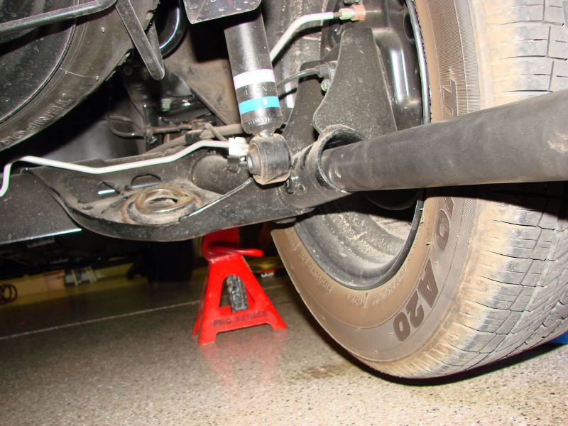

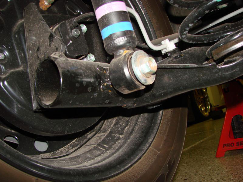

The rears are super – easy! Get the tail of the car up on jackstands, but this time, make sure the rear tires are about 8″ off the ground. No need to remove the wheels. Place the jack under the rear control arm, directly under the spring, and jack it up just a little (enough to support the spring). Remove the silver bolt that goes through the lower shock mount.
Now, the fun part: Place your jack handle in the round suspension arm (where the lower shock mount attaches to). Have an assistant press down on it. This will free the coil spring.
Remove it, and swap the rubber isolators onto your new spring and reinstall it.   Once it’s installed, have your assistant lift up on the jack handle to compress the spring a bit. Reinstall the lower shock mount bolt. Repeat on the other side, torque your bolts, and you’re finished!

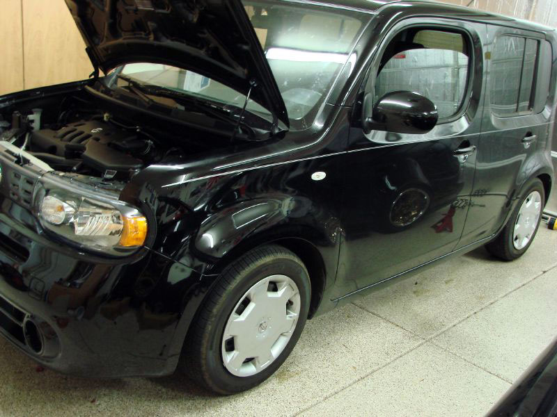

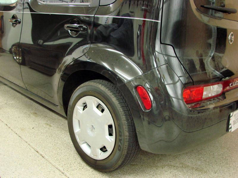

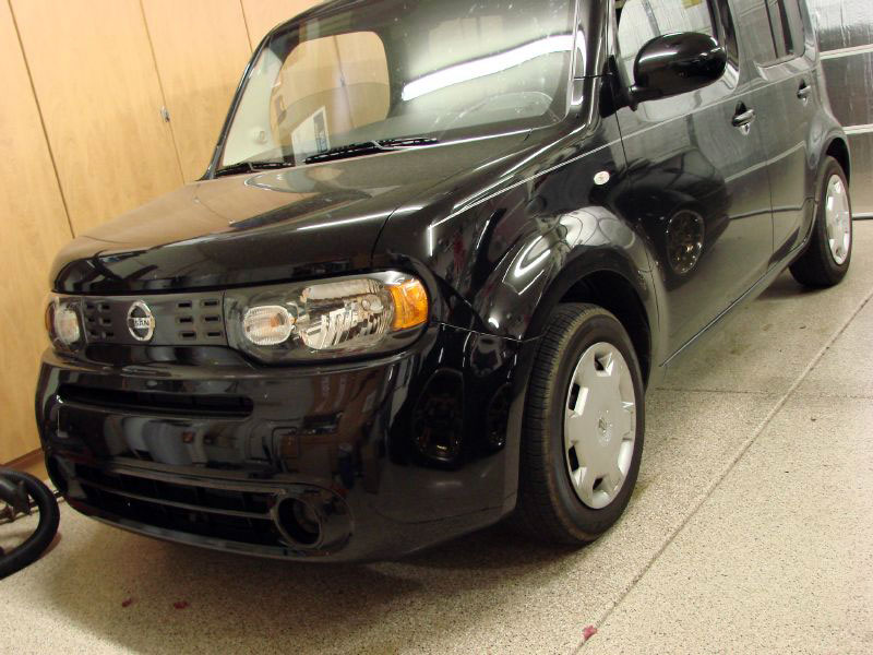

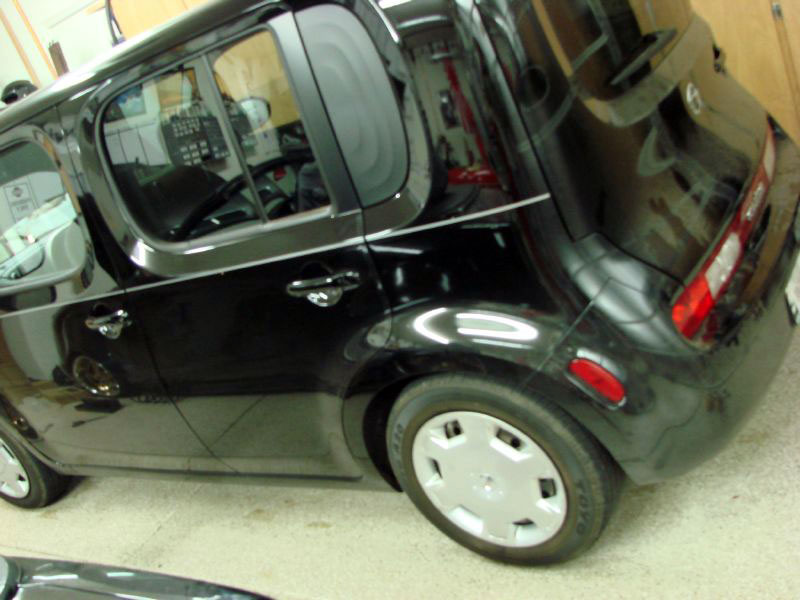

Some comparison pics:  Before and after
My impressions: Of all the cars I have lowered, and I have lowered over 30 cars, this one made the most dramatic difference. No longer floaty and disconnected, the improvement is very noticeable. Cornering and braking are improved, and the ride quality didn’t suffer. It looks a TON better, and now it’s ready for wheels and tires. Stay tuned!
