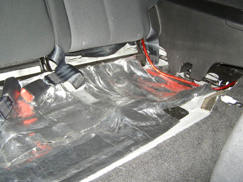

Once the seat is off apply material to the exposed surfaces.Next, pull off the lower plastic panels in the back, these are the big ones that go all the way from the door to the rear deck and have the cupholders in them. you will want to lower the seatback to get some of the clips out. this part is tricky, but there is an "aha!" moment when you realize that once the top clips are out you just pull and it all comes out.

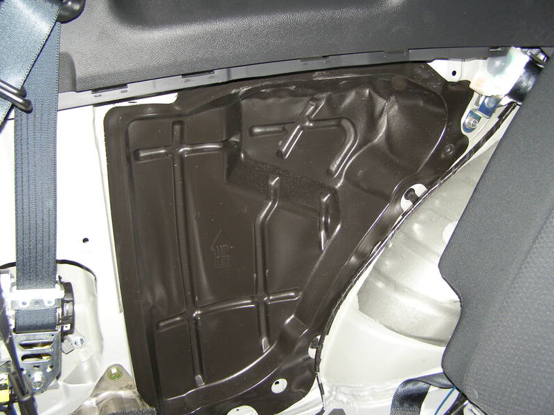

Once the panel is off, a rubber cover is exposed. Just peel it off. Also, try not to get it dirty or too bent, so we can just put it back later.

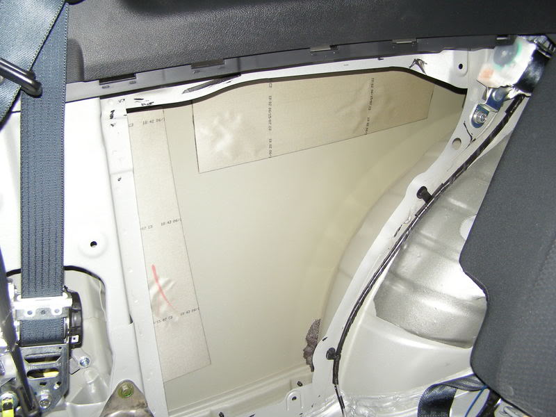

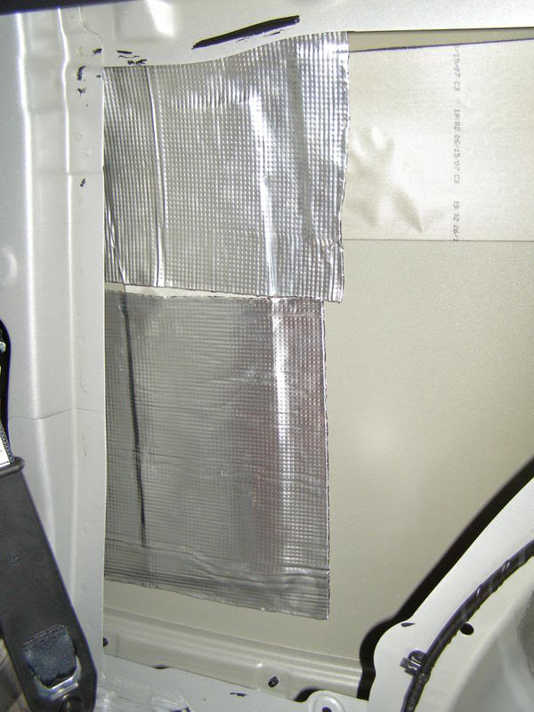

Now the exterior panel is exposed. By this time, the carpet is also loose and now its time to start applying all the material.
In progress…
Done. Be sure to cover the wheel well. this is a large source of road noise. heres something cool: once the side wall is done, get outside and start tapping somewhere near the tail light. Work your way towards the door and notice the huge difference in sound when you get to the parts that are done.
Continue applying to the floor and exposed areas. Then drive the car and notice the huge difference in road noise. To reinstall just go backwards with these steps.
