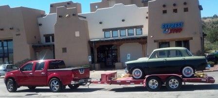

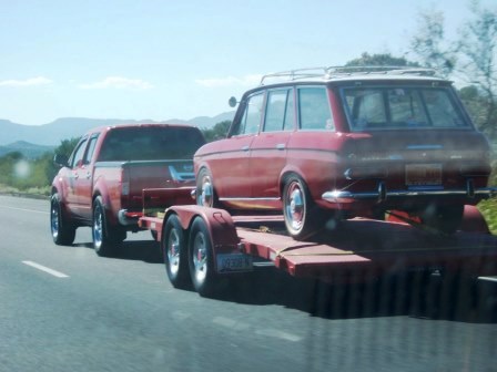

As many of you know, the NICOclub Support Vehicle is a 2005 Frontier Crew Cab 4×4 with the VQ40 and a six-speed transmission.
Generations Aside from being the best vehicle out of the 60+ we’ve ever owned, it’s a trouble-free towing beast that we use to haul our classic Datsuns all over the southwest. Even at 130k miles, she’ll pull a 7% grade with a dual-axle 18′ steel trailer loaded with an old Datsun at 70mph with the AC on all day long, and aside from being a little thirsty in the fuel department, she’s as enjoyable to drive as when she was new – and still looks damn good doing it.

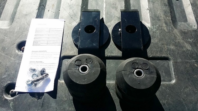

Fast forward a few weeks, and Timbren offered me an opportunity to test out the SES Suspension kit. Here’s what I received:
timbren_ses_review_01

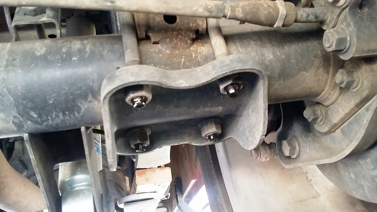

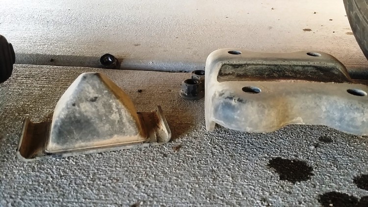

Using a jack, raise some of the weight off the suspension (don’t lift the wheels off the ground, just take the body of your truck up 1″ or so). Remove the four nuts holding the shackle block in place, and remove the original factory bump stop. You can see why “bottoming out” in our trucks is so uncomfortable – the original bumpstop is hardly an impressive design, and certainly isn’t progressive.
timbren_ses_review_06
timbren_ses_review_07
Place the new assembly in place of the old bumpstop, and put the U-bolts back in place. Reattach the shackle block, making sure to tighten the nuts evenly in a criss-cross pattern.

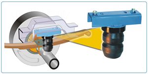

timbren_suspension_1
The Timbren SES solution is engineered to absorb and cushion road shocks and vibration when you are rolling with a full load – They don’t do a thing 90% of the time, but when you do compress the suspension, they come into play – gradually and progressively stiffer, just like a proper spring. This increases comfort and eliminates that harsh feeling and axle rebound, while keeping your truck level.
