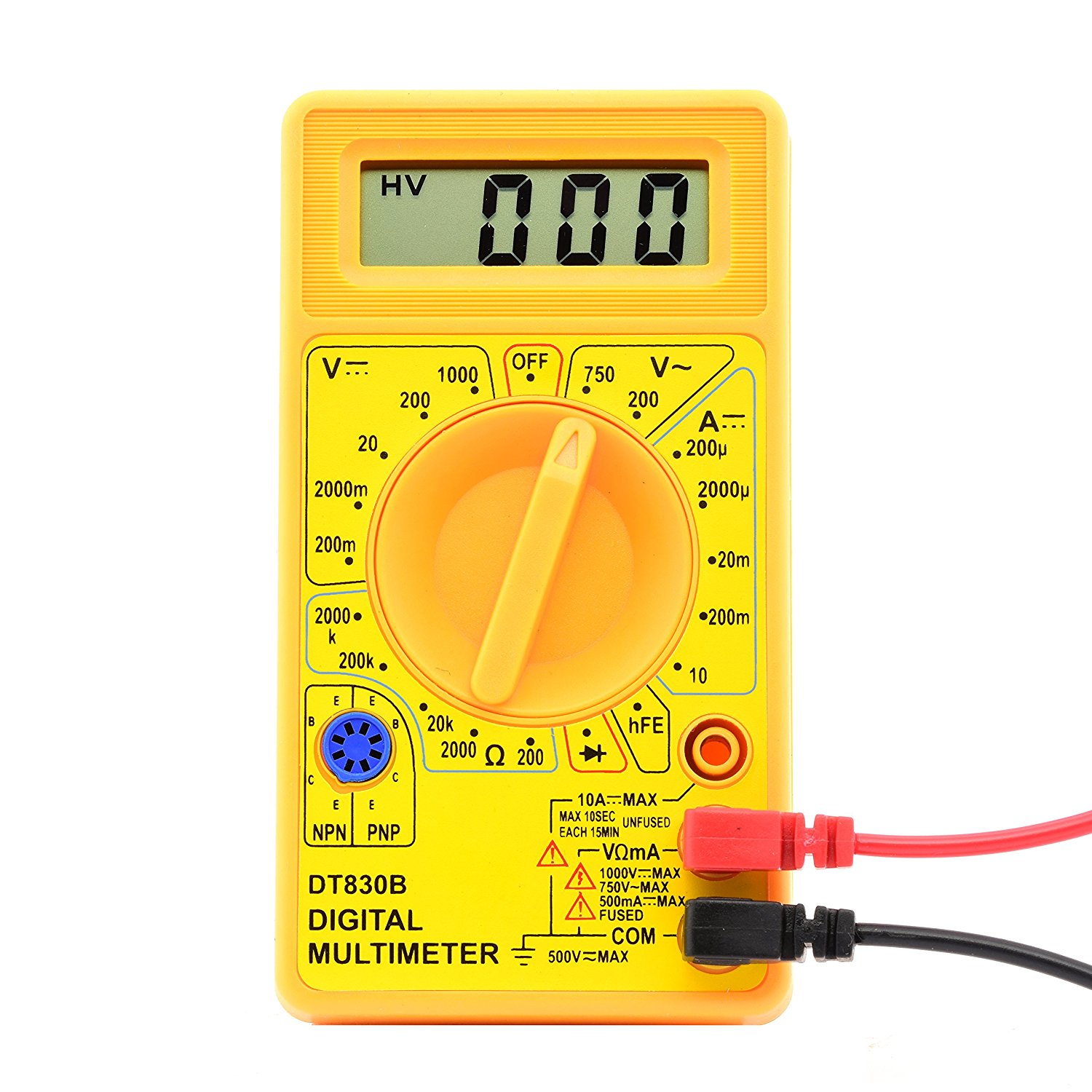

First order of business is simple: We’re checking for voltage. You don’t need a fancy tester for this – in fact, the $3 (or sometimes free) multimeter from Harbor Freight will do this job just fine. Turn off any electrical items in the car, switch the dial to the 20V position and put the red probe on the + terminal, black probe on the – terminal. You should see 12.5 to 12.8 volts.

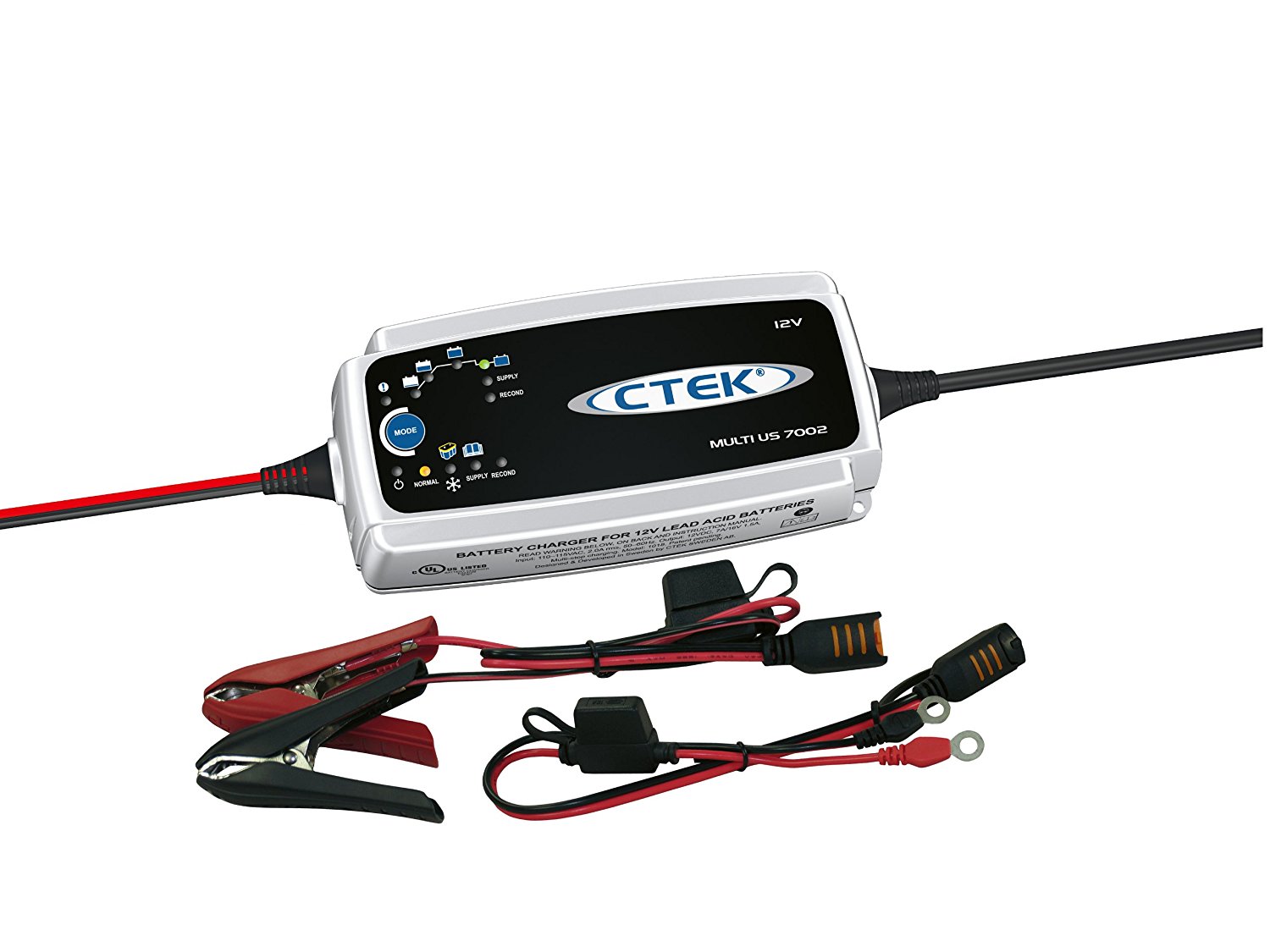

If the battery voltage is low, stop now and put your battery on a battery charger until the open-circuit voltage is 12.6 volts. I like to use a smart charger, such as the one from CTEK:
Don’t be tempted to simply jump-start your car and think the alternator will charge it. The alternator isn’t designed to produce that amount of current for that long and may be damaged – plus, a badly-discharged battery has high internal resistance to any charge. Buy a quality battery charger – the smart chargers, like the one pictured above, won’t overcharge the battery, so there’s no danger of cooking off the electrolyte.
