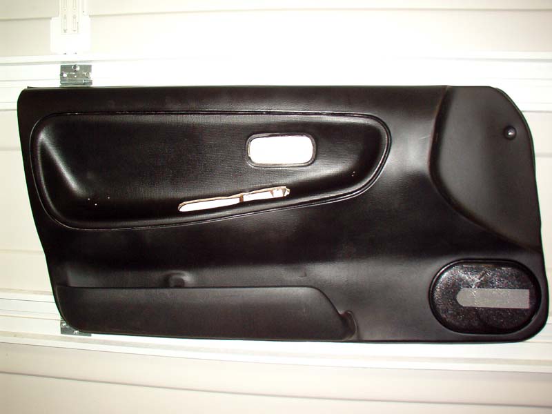

At any rate, this began the revamping of the interior of Project Vert. The new door panels (sourced from a local coupe) made the seats and carpet look terrible, so those were discarded in favor of a new molded carpet and a set of black leather S14 seats.

I stripped the tweed covering off the door panels and glove box, removing the leftover adhesive with Goo-Gone, and gave them several treatments with 303 Protectant (best vinyl product on the market). The Convertible didn’t come with a grab handle on the passenger side, so I grabbed one from a junkyard and added it while I was redoing the doors.  The rear seat side panels had leather inserts that matched the factory seats (light grey), so those got a couple coats of black Leather Dye to match the S14 seats.
