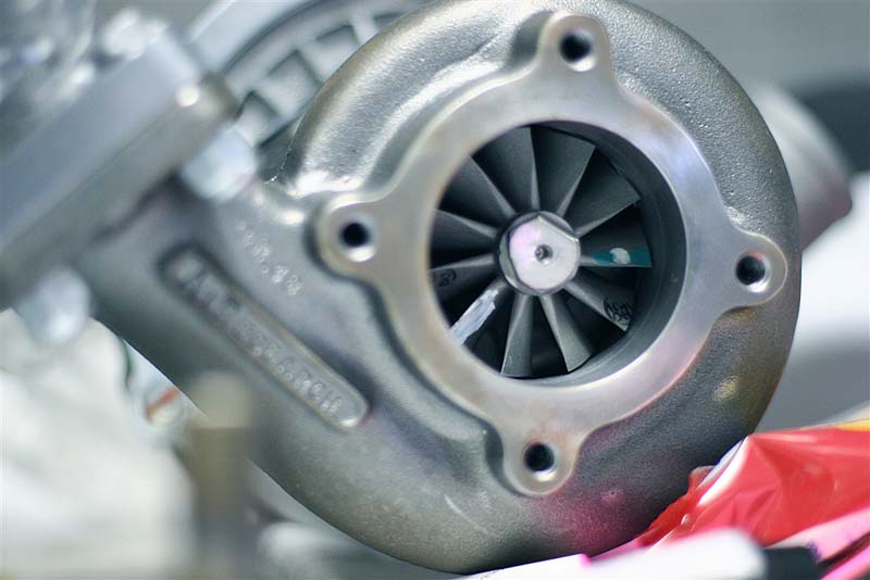

At the time, we had a sponsor on NICO who was building an entry-level turbo kit for the S13. We talked at length, and planned a date for the install – the owner of the company offered to fly out and assist with the install – Can’t beat that, right? I wrote the check, and anxiously awaited the arrival of “install day”.

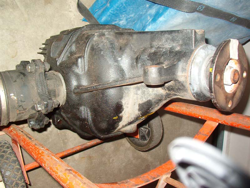

With one week left before the turbo kit install, I had dropped by a local vendor’s shop to pick up some t-bolt clamps (so I didn’t have to use the cheap worm-drive hose clamps)… I had hooked him up with a couple customers lately, and he had a “present” for me: A 4.36 VLSD from an R32 GTS-T. How can you pass THAT up? Into the car it goes. I already had quite a bit of experience swapping differentials (the Q45 had gotten a 4.08 upgrade less than a year earlier), so the swap was gravy.

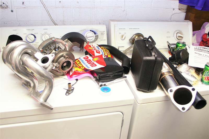

The turbo kit arrives, and I get a crash-course in “how stuff works” the night before the install. I hadn’t messed with a boosted car since the late 80’s, playing with the old T-Type Buicks, and this was a whole new world.

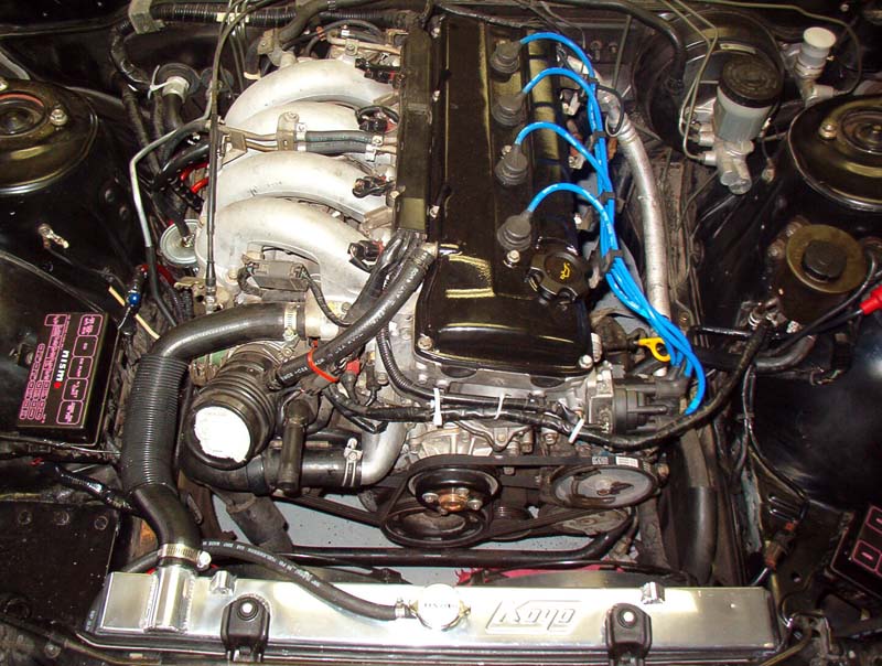

Compression on the original KA was tested, and it was 168 across all four cylinders. The engine was obviously well-maintained (remember the earlier pics of the inside of the head?) At the time, the prevailing “wisdom” was that a stock KA would handle mild boost without flinching, and simple fuel management was sufficient to maintain adequate protection from detonation. A set of 370cc injectors was sourced from a fellow NICO member, and I finally had all the parts ready for the “Big Day”.

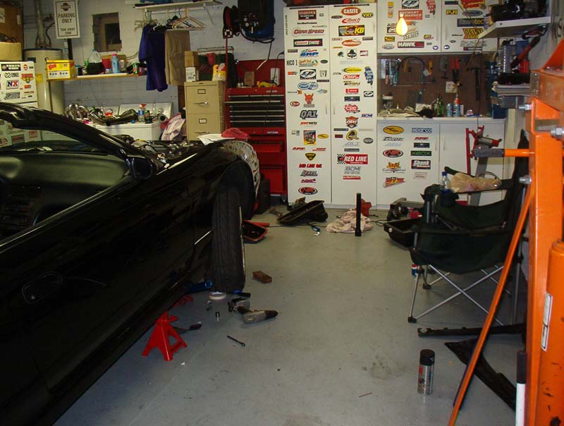

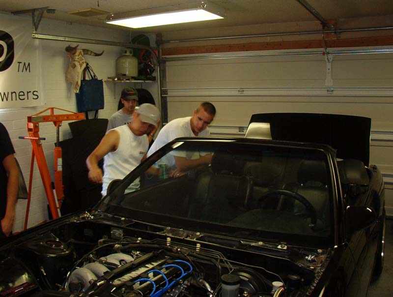

We put the word out to the locals, and a full-blown “Tech Day” ensues. AZ240 are a great group of guys, and you couldn’t ask for a better bunch of friends. Lots of pizza, lots of soda, lots of beer, and lots of fun….

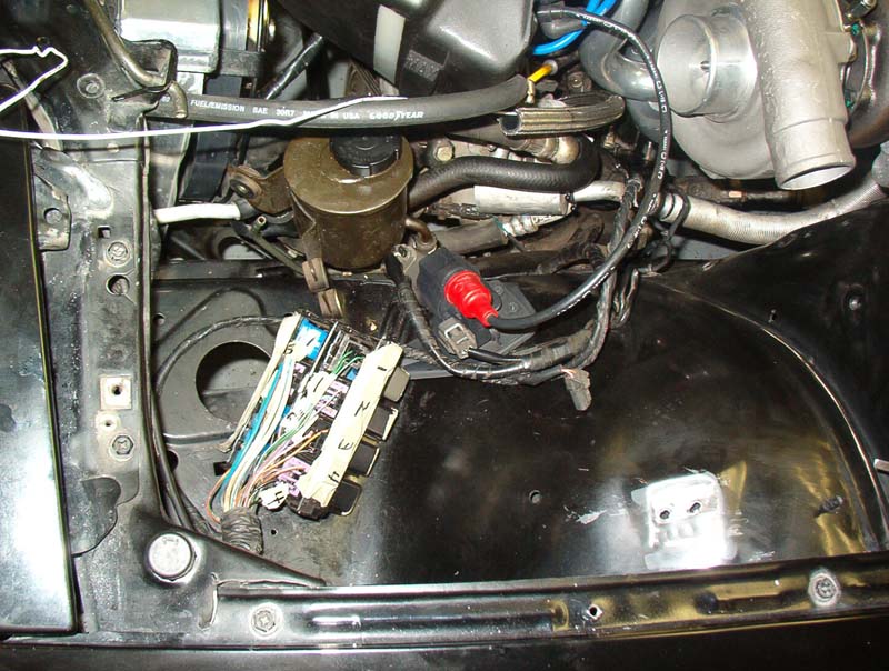

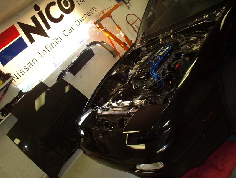

The install seems to take forever, and I feel like I’m slowing the process down. I make myself useful and install the Walbro fuel pump and relocate the battery.

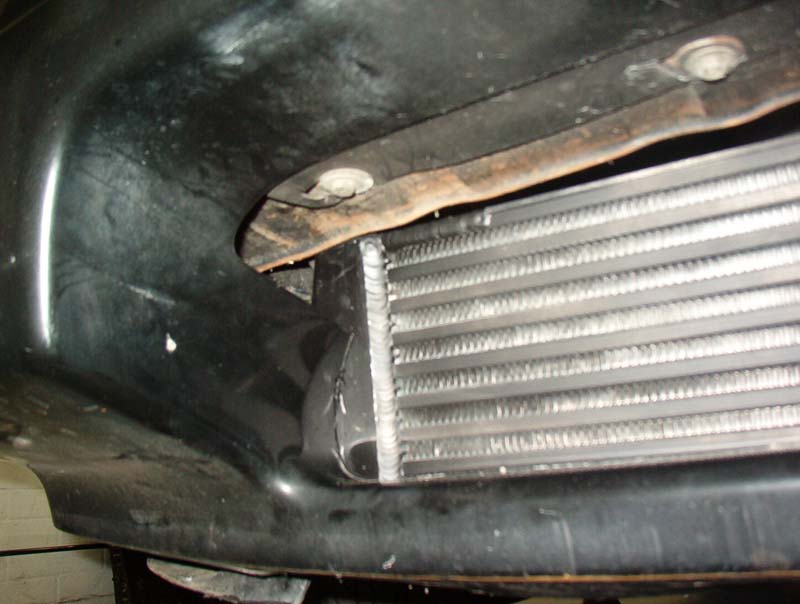

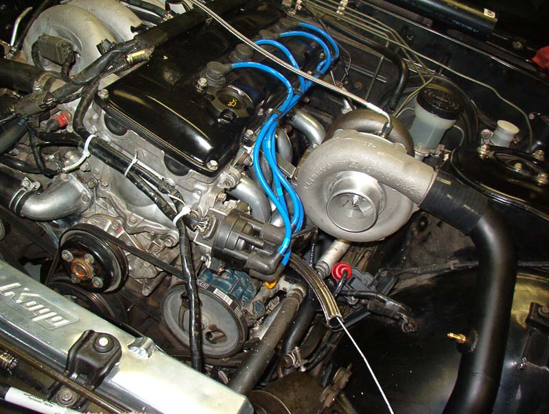

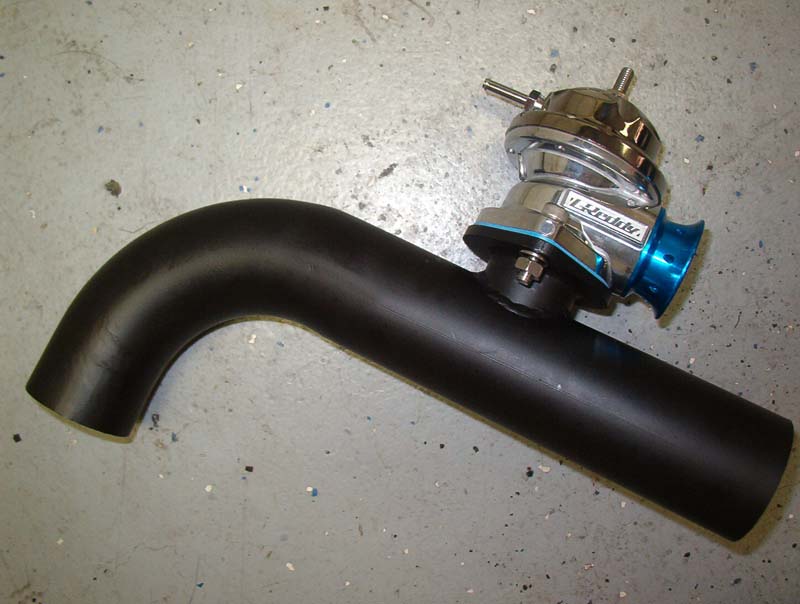

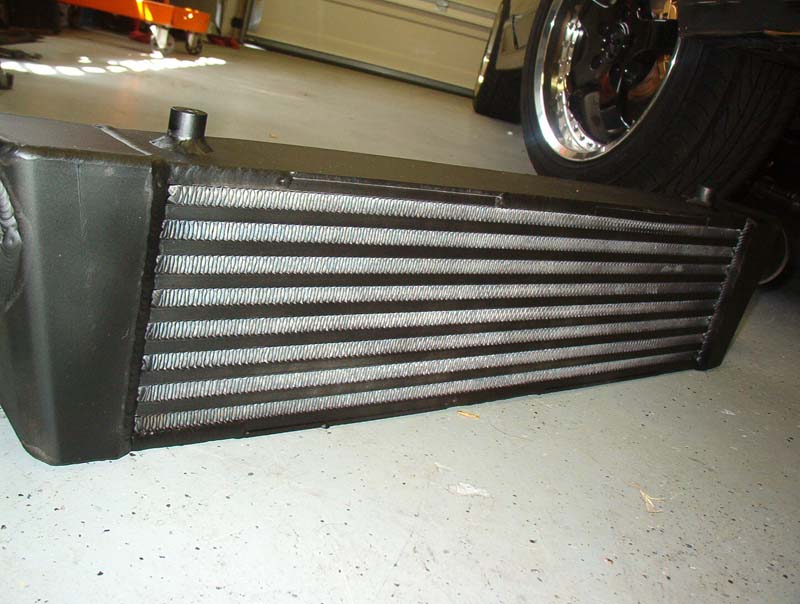

Saturday rolled into Sunday, and the local 240sx guys are troopers – They hang in, wanting to see the project through to completion. Intercooler gets mounted, piping is routed, manifold connected, downpipe and exhaust re-installed, gauges wired up… A swarm of activity all over the convertible.
Now, the plan for this setup was to run 5psi at first (via a Tial wastegate with a 5psi spring), and then step up to 8psi after everything was running smoothly. 8 psi on a KA is nothing to sneeze at, and should put it around 225 hp, right where I wanted to be. I sourced an SAFC-2, and it got wired in with the rest of the kit.
After 2 long days on the project, it was time to fire it up. She cranked over just like always, and settled into a low rumbling idle. The sound was a little different now, and you could sense the excitement as everyone wanted Project Vert to acclimate to her newest additions smoothly. Some adjustments here and there, a few vacuum leaks to chase down, check the plug gaps, check spark / fuel pressure, dial in some “safe” settings on the SAFC, and she rolled out into the street, prepared to “do the nasty”.
