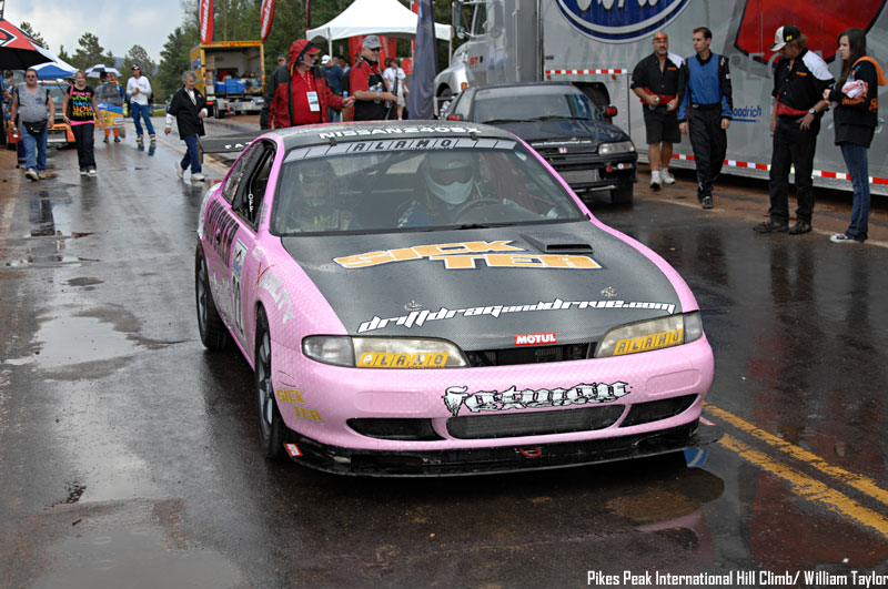

As I’m watching the last of my ATV buddies leave the line, the race director comes over and tells me and Travis to load up. Rain is moving in. Travis and I get loaded and we are rolling into the fourth position in the staging area and the rain starts coming down. The hail soon follows and soon we are in a mini-monsoon. A drenching rain. We have people holding umbrellas over the side windows, but Travis and I are still getting pretty wet. So is all the stuff just inside the window, like my tachometer and electrical gauges. I don’t think any of it is water proof. We are waiting out the rain when Randy Rhule comes over and informs us that instead of going last, we’re going first. Rhys, as the number one qualifier, has the right to reverse the run order in our class. And since it has been pouring rain for the last 30 minutes, he decides to use us to help dry the track before his run. No problem. Not only do I have little time in the car, but I have no time in the car in the wet, and I have little confidence in my bargain basement tires. This should be interesting. Oh well, just one more challenge in the long list of things we have had to overcome to this point. Rhys comes over and leans inside the window; “Sorry mate. Good luck, I’ll see you on the summit”. Travis and I roll up to the line behind the last couple cars of the class in front of us. We get reports that there is standing water on the course for at least the first two miles.
The green flag drops. Time doesn’t start on the green flag, it starts when we cross a timing loop buried in the road about 75 yards in front of us. I am taking my time. I look over at Travis and ask him if he’s ready. “YES!” I rev the motor and ease out the clutch. We are finally on our way. I immediately find that the road is slick and my tires have little traction. The feeling is similar to the dirt sections, except we have more traction in the dirt. Each corner we enter I can feel the front end pushing hard and as I reel it back in, the back end starts to get loose. I have to drive more conservatively than I want to. We’re making our way, but it’s a real handful.

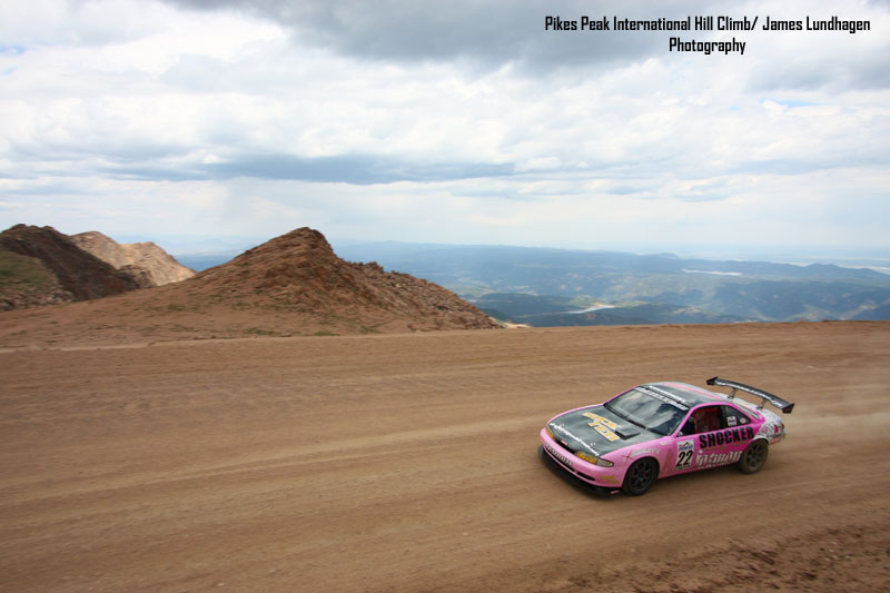

A little less than two miles in and we are still making our way through standing water and very slick conditions. Then, suddenly, we come around the corner at Horseshoe and the road is completely dry. It was as if it hadn’t rained here at all. I looked over at Travis and smiled, and then I put the accelerator on the floor. We had about another mile of pavement to make some time and I was doing my best to take full advantage of it. We got in and out of the hairpin at Engineers pretty quickly and we had a great run into Halfway Picnic Grounds. I’m not sure how fast we were going there, but I’m sure it was as fast as the car had ever gone. We work our way through the lower dirt section. I feel like we made pretty good time considering the wet start. The second paved section above Glen Cove goes really well. I am keeping a close eye on the temperature gauges since we haven’t had very long runs under power until today. As we get to Ragged Edge, just below the W’s, I see the water temp gauge start to crawl past 200. Until now the temp hadn’t gone above 190. I’m not slowing down. This is my favorite section and I’m determined to get through here quickly. On the second leg I see the temp at 210. I’m a bit concerned. I don’t want to burn down before we make the summit. I feel like if we can get up to Devils without overheating we should be ok. There are a lot of long straight runs above Devils, and it’s all dirt, so I won’t be working the engine quite as hard. We get a good run onto the fourth leg heading into Devils. There are thousands of people up here and they are all by the road cheering us on. I brake hard coming into Devils and get the back end around smoothly. We’re back on the dirt and look down and see the temp gauge slowly coming back down to 190. We safely negotiate the corner going into Bottomless Pit, named for the 6000ft drop off waiting for you if you miss the turn. Safe? Not yet – some idiot runs out and crosses the road just in front of us. A quick brake check before the corner and now we’re creeping up the 10% grade leading out of the turn. Thanks buddy! We get back on the boost and continue up the road. We’re doing well. I feel that we are faster than we were on the practice day. Of course, all the lugs are tight today, so we should be. We make it through Gravel Pit and Boulder Park and have the finish line in our sites. Just Cog Cut and Olympic Hairpin and we are home free. Cog Cut goes well and as we are coming into Olympic, we see our friends, and Travis’s dad, who had finished the race earlier, cheering us on and waving us towards the finish line. In my enthusiasm, I almost blew the exit and tried to drive us into the ditch. Narrowly averting disaster, I was able to collect the car and we made our way across the finish line.

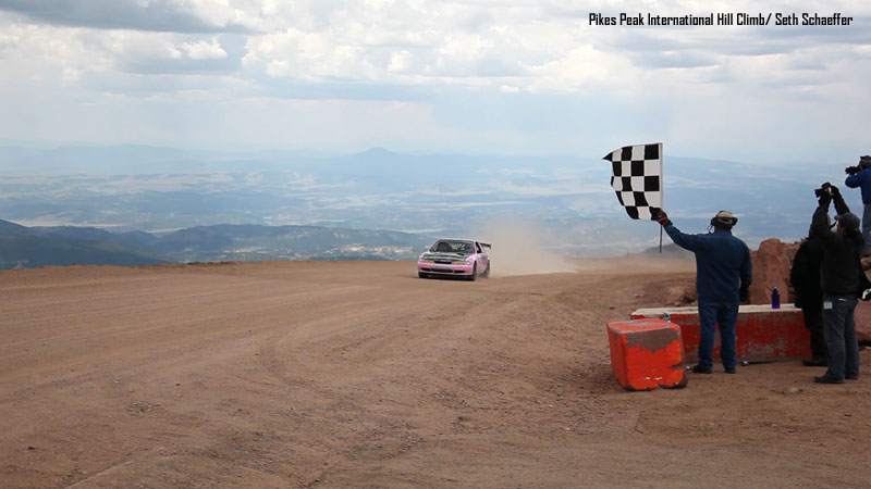

What an amazing feeling. I didn’t know if I should scream or cry or what. Turns out, I didn’t do anything. I just looked at Travis and thanked him for sharing the experience with me and we rolled up to the spot the safety team directed us to park. I asked Travis which truck had brought his chair up. He pointed it out and I crawled out of the car and began to make my way over. Not three steps out of the car and Monster Tajima was heading my way with his hand extended. I was now shaking hands with the current Pikes Peak record holder. He was the first to congratulate us and immediately began taking pictures of the pink car and was leaning in the window to speak with Travis.

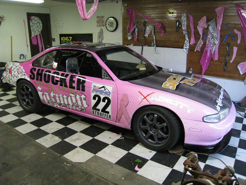

Details on the car:
Build time = 11 months
1997 chassis
1995 front end
2.4L KA24DE-T
L19, 11mm head studs
O-ringed deck and copper head gasket
Lightly ported intake and head
BC Springs, Retainers and Locks
Kelford 272 Cams
Eagle Rods
Fully balanced crank
1200cc Lucas injectors modified by Alamo Autosport
Competition stage 5 clutch and flywheel
Stock Transmission
B&M Short shifter
Stock driveshaft
Stock third member with S15 Helical diff and 4. 08 gear
Stock axles
Z32 rear brakes and rotors
StopTech front big brake kit
Modified stock suspension links
Megan Racing rear lower toe arms
Wilwood pedal box and master cylinders
MB Weapon wheels
17×8 front with 245/45-17
17×9 rear with 275/40-17
Precision 60-1 turbo with . 36 AR
STS system mounted in back seat
TiAL 38mm Wastegate
TiAL BOV
18”x9”x2.5” in and out IC
Custom 2. 5” and 3” exhaust
AEM ECU
AEM Boost gauge
AEM UEGO
Stewart Warner Gauges
AutoMeter Tach
Kirkey racing seats
Crowe restraints
Def-N-Der Neck Brace
Simpson helmet
Tuning by Brice Yingling at Alamo Autosport
Suspension setup and corner balancing by PTP (Pro Tuning Performance)
Vehicle graphic design by Travis Tollett
Printed and Applied by Imagewraps
