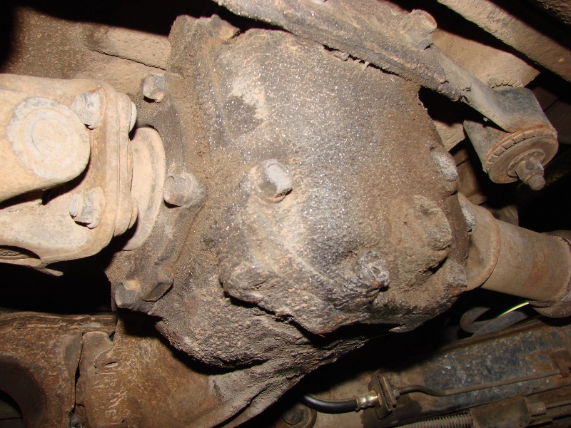

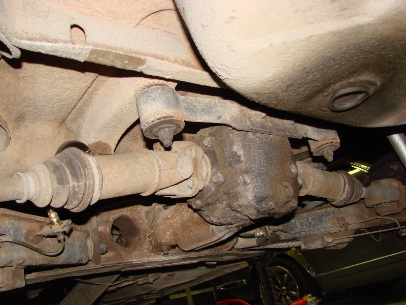

Anyhow, here’s what we’re starting with. Note the 45 years of accumulated grime (click to enlarge):
With the rear subframe removed, we can see this rear end wasn’t in bad shape. The grime has preserved it really well, and now that it’s out, it’ll be easier to work on. The 510 subframe is relatively simple to drop: Two front bolts, two rear bolts, the brake lines and the parking brake cable – I dropped mine in less than 10 minutes by myself using 2 jacks.

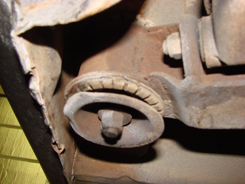

Have a look at these subframe bushings… Yeah, these weren’t doing their job at all!
510 subframe bushings
The next couple days in the garage was spent with a wire wheel, blast cabinet, torch (for burning out the old bushings), a reciprocating saw with metal blade (for removing old bushing shells), and lots of degreaser, green scrubbing pads and paper towels.

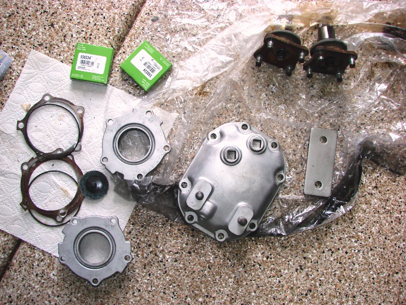

Before I dug into the suspension, I wanted to get the replacement differential refurbished, so that I could just attach it to the subframe and reinstall the whole thing as an assembly. I chose a R160 LSD differential with a 3.90 gearset, which should perform nicely with a 5-speed and a built L20b. So, the whole thing got pulled apart and cleaned. Since the diff carrier itself was such a grungy chore, I went back to an old hot rodder’s trick of using acid to degrease and prep the metal. After removing the seals and all components, the carrier got dunked in muriatic acid for the better part of a day. NOTE: Pool acid is cheap and effective, but it will burn the living piss out of anything it contacts, will eat right through clothing, gloves and skin, and creates noxious gases that will put you on your ass with a quickness. Unless you’ve used it before, skip it. Seriously. However, I’m a professional (yeah, right). After sitting in the acid, the carrier was hoisted out with a hook, rinsed thoroughly, dried with an air gun, and painted immediately (to prevent flash rusting). Dispose of the acid PROPERLY (no dumping it in a drain or on the ground)! Here’s some before and after photos of the diff carrier restoration:

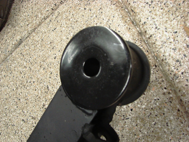

As with the front suspension, all the hardware got tossed in the tumbler for refinishing while the rest of the parts were being worked on. Here’s what they look like after being rinsed and clear-coated, as well as pics of the rear control arms and subframe after getting fresh paint and new polyurethane bushings:
During reassembly, DON’T forget to use the “snot” (silicone-based lubricating grease) on your new bushings – If you don’t, you’ll have squeaks and it’ll all have to come apart again. Take your time and do it right the first time. This stuff is fun, right?!
