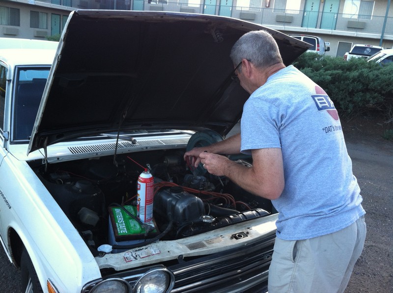

We woke up this morning looking forward to making it home after seven days on the road, while spending our evenings in cheap motels. The car started right up but as soon as we put it in drive and headed down the driveway to top off fuel, the car quit, rolling into the gas station next door. There was no restarting it this time. Another call to Dr. 510 (6:30 AM his time) and we had several things to try, to begin eliminating potential issues. There were three things we thought could be the culprits.
After removing the air cleaner, we noticed the automatic choke didn’t seem to be opening fully, even when the car was fully warmed up. This would account for the loss of power and the recently declining fuel economy, since the throttle plate was never fully opening. But this wouldn’t likely contribute to the car stalling and not restarting. Nevertheless, I wired the choke fully open and replaced the air cleaner lid.
Next, I unscrewed the bolt that gave access to the small bronze carb filter and float valve, to make sure there was no debris in them and that they were functioning properly (all good).
Finally, we checked the points to verify the gap was correct. Doc had previously mentioned this was a common issue on 510’s, leading to all kinds of drivability issues. One of the point sets was gapped properly but the other one was nearly closed when it should have been open .020. After opening the points up and putting everything back together, the car finally started and ran with some power again.

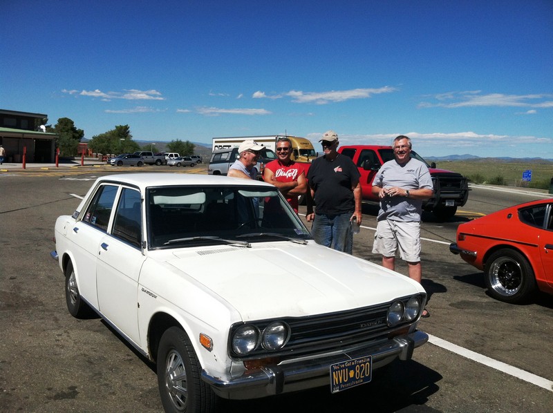

Three of the guys in our car club, Desert Datsuns, told us previously they would like to meet up with us on the final day and escort us into Phoenix. We decided to meet at the “Sunset Point” rest area an hour north of Phoenix. It was great to see familiar faces and show off the new car before getting back in for the final hour home.
