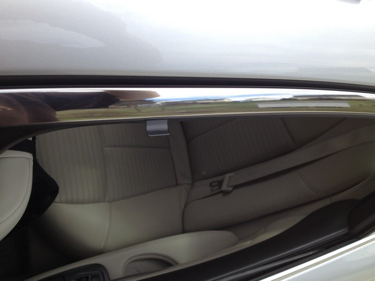

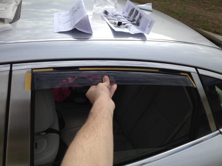

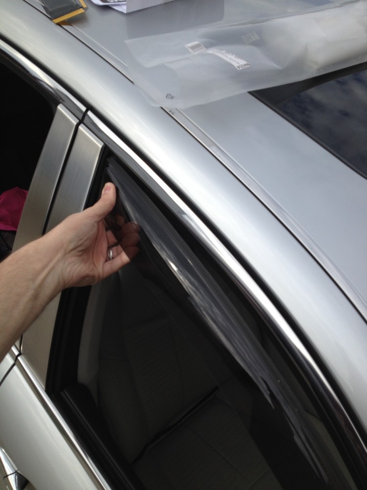

The only tool needed is a metal hook, that is supplied, to pull a rubber seal back to place 2 metal clips into the rear window channels. For both the front and rear it is simply a matter of placing the visors’ edges into the window channels. Bending the visors allows you to start each end and then working the middle into place. After that you roll your windows up gently to set the visors.

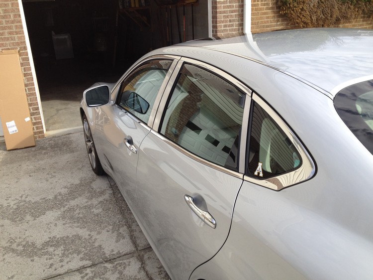

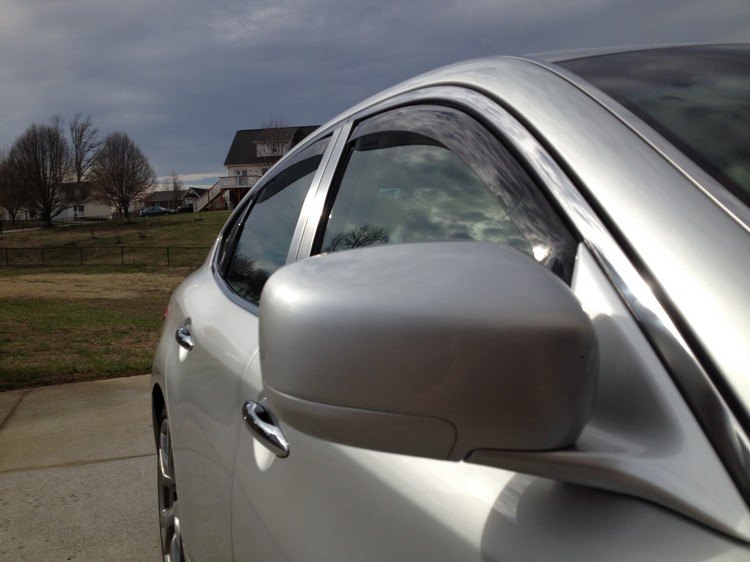

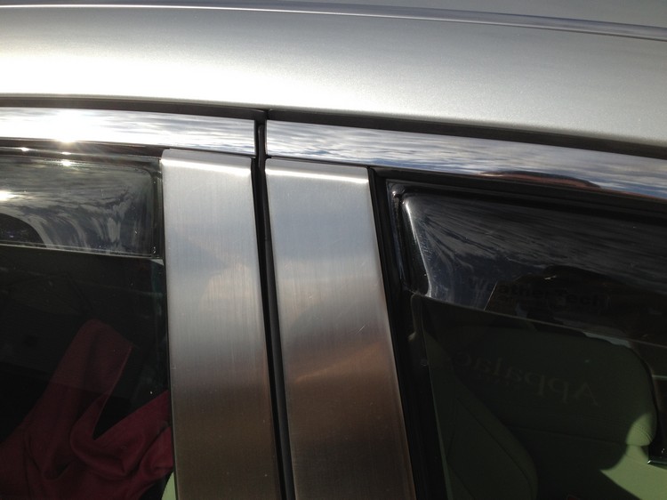

The visors look great, with factory-appearing fitment, and do not interfere with the body lines. In fact, the look of the car has improved to me. Overall, these are a great fit, great look and a very easy/quick install. And at $114.95 per set, plus free shipping, it was a great value!
