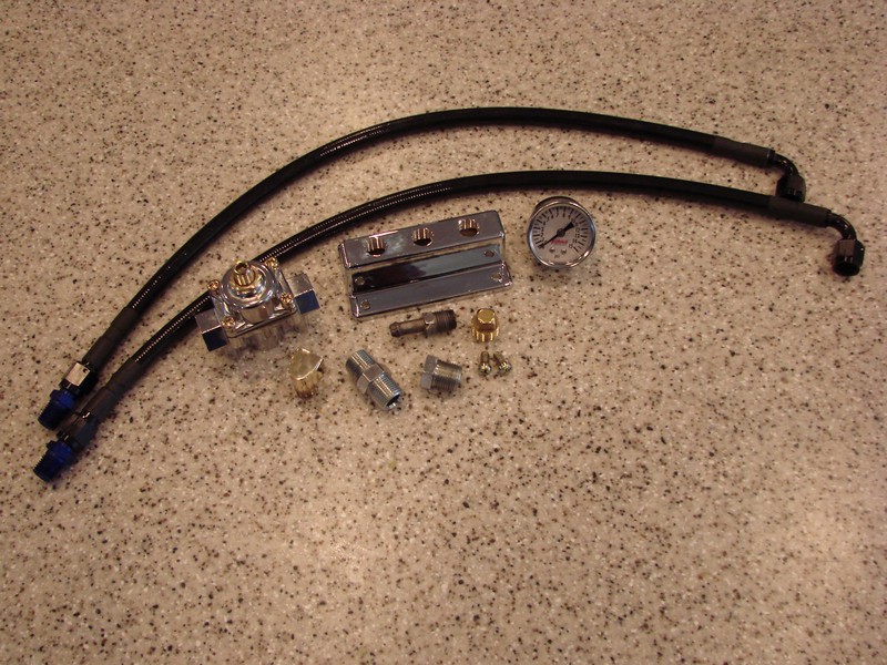

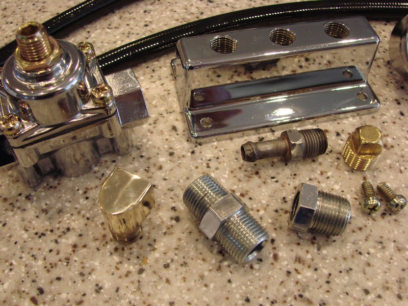

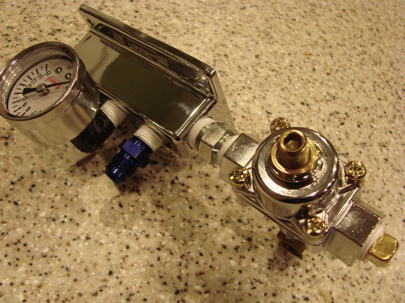

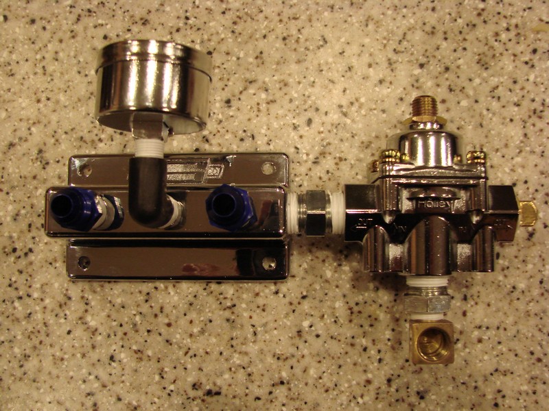

While waiting on the carbs, we went ahead and assembled a fuel system for the 510. Rather than running a simple “T” on the fuel line and hoping both carbs get equal fuel, I decided to run a fuel distribution block as well as a fuel pressure regulator and a gauge. You’re probably thinking, “Who runs a FPR on a carbed setup?” Well, with a mechanical fuel gauge, the fuel pressure can vary quite a bit, and it also delivers in pulses. This would smooth out the flow and ensure that we’re not pushing more fuel than the carbs need. Even though the floats will do their job, this will keep them from being pegged to the top all the time (or starving for fuel during hard cornering).
datsun_510_fuel_system_002 datsun_510_fuel_system_003 datsun_510_fuel_system_004 datsun_510_fuel_system_001
And here it is mounted to the side of the fender:

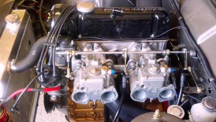

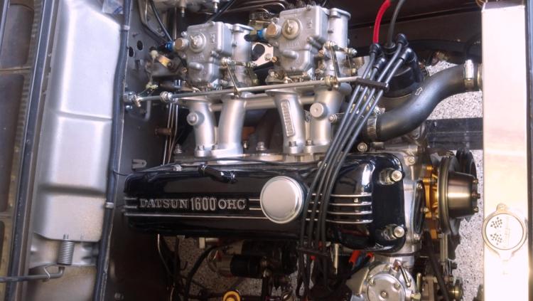

With that out of the way, and the carbs ready to install, it’s starting to look like a functional engine! I can already tell that the custom linkage is going to be problematic down the line. It’s not exactly the way I want it, but I also don’t want to go the slacker route and run a pull-cable, either. We’ll come back to the linkage later, after I do some more research.

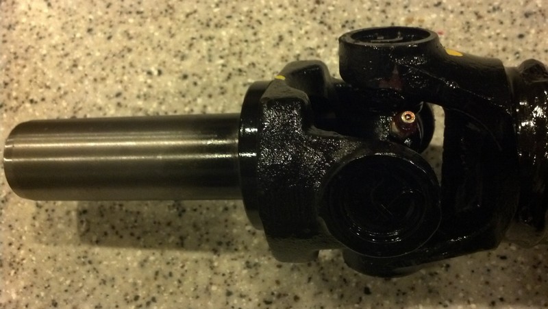

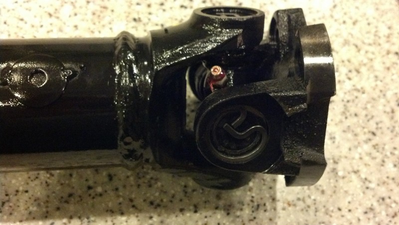

We’ve still got to snag some air horns / velocity stacks for these, and a couple of the venturis were wanting to work their way out of the carburetor body. We’ll get some of those bits tidied up later. In the meantime, the drivetrain shop called to tell us our driveshaft is finished, so we’ll install that next.
510_driveshaft (2) 510_driveshaft (1) 510_driveshaft (3)
Sexy stuff, huh? Check out the zerk fitting for greasing the u-joints! This should work out real nice.
