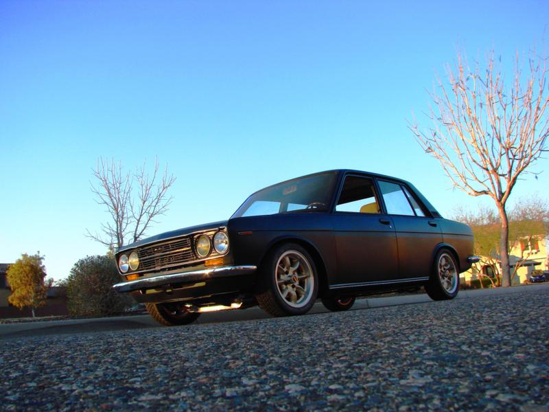

Since it had been over a year since she’d seen the light of day, I decided it was a good time for her to get her first bath.
012 008 010
1968 Datsun 510
This gave me some time to mentally sort out all of the issues I took note of during the drive. She was bogging badly on acceleration, the brakes felt spongy, she tracked terribly, and of course needed an exhaust.

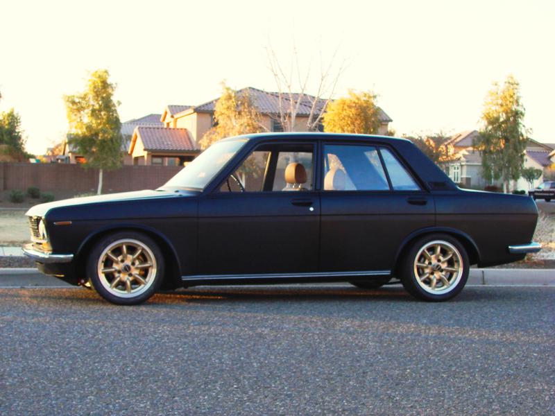

A lot more tinkering with the carbs, a distributor swap, and a few other tweaks got her running smoothly. A quick trip up to Network Alignment here in Phoenix got her rolling straight and true. Incidentally, once the alignment was set to the preferred “street / performance” specs per the rest of the 510 community, I found that I had picked up a little more space in the rear fenders for wider tires! The 195/45/15’s looked great, but I prefer a little meatier rubber on my cars, and this thing was going to need all the traction it could get. There was no time to swap them out right now, but we’ll come back to the tire decision a little later.

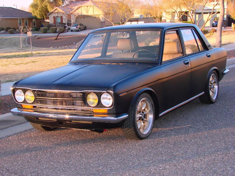

A week left to go – and we still didn’t have “the look” I was after! Well, Alex Lopez from SkyPrintMedia came to the rescue. I showed him some pictures of the BRE 510’s of the 70’s, and asked him to cut some vinyl stripes that would match the wheel centers. With a short timeframe, he came through, and at the end of the day, I had this:
Datsun 510 BRE stripe dimensions
I think we can take her to her first event now, without embarrassment. With a bunch of NICO folks coming in from out-of-state to help out, we didn’t have much time to spare… and just as time was running out, another setback almost spoiled our plans… Join us for Part 14 of Project 510 Build!
