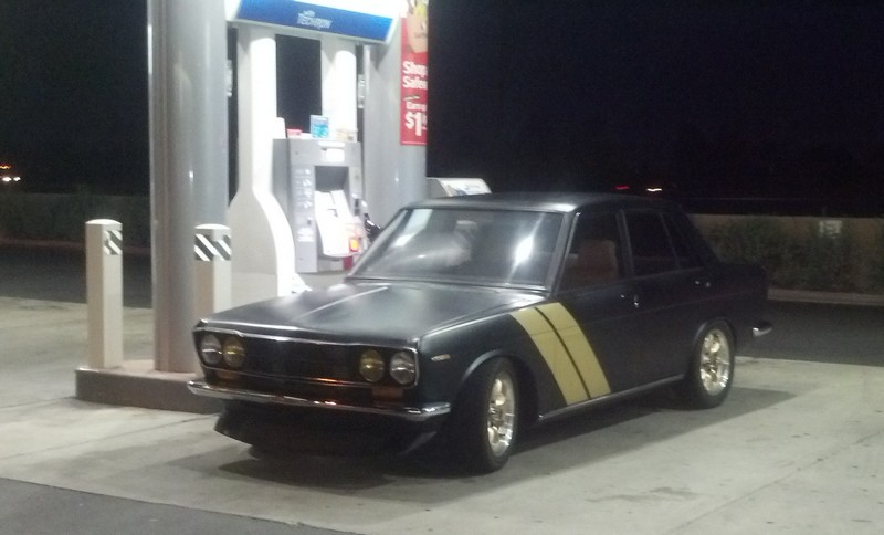

Over the next couple weeks, I did a lot of little things on the Project 510 that don’t really lend themselves to including in the build article. A new set of modern 3-point seat belts from Westco were installed, as well as a trio of basic gauges in order to monitor engine functions. We decided, that since this car would see some daily-driving duty, it would need the windows tinted… so it got fresh tint on all the glass. A BRE-style Spook front lip with functional front brake ducts was added.
Also, the tires that were on it were starting to show their age. As I mentioned earlier, the alignment gave me a little more room in the rear, so I decided to step up to a set of 205/50’s on all four corners. As it turns out, my MazdaSpeed Miata had a fairly new set of 205/50’s on it, but I had been wanting to buy a sticky set of high-performance tires – so a three-way swap commenced. The Miata got some new Direzza Zii tires, the 510 got the Miata’s hand-me-downs, and someone on Craigslist got a free set of 195/45’s.

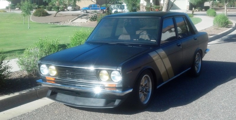

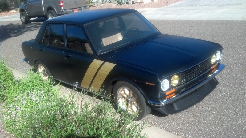

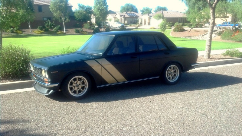

No pressure. We got this. In fact, I even took time to shoot some more pics of the 510.
1968_Datsun_510_NICOclub (4) 1968_Datsun_510_NICOclub (3) 1968_Datsun_510_NICOclub (1) 1968_Datsun_510_NICOclub (2)
