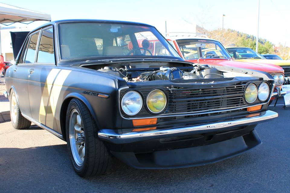

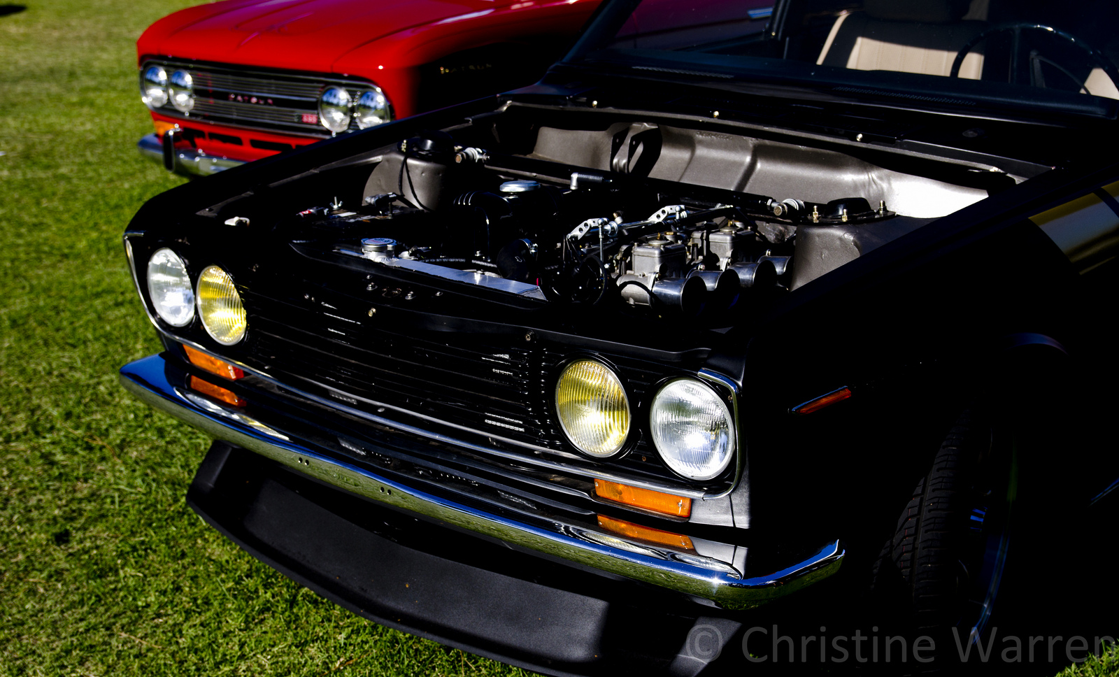

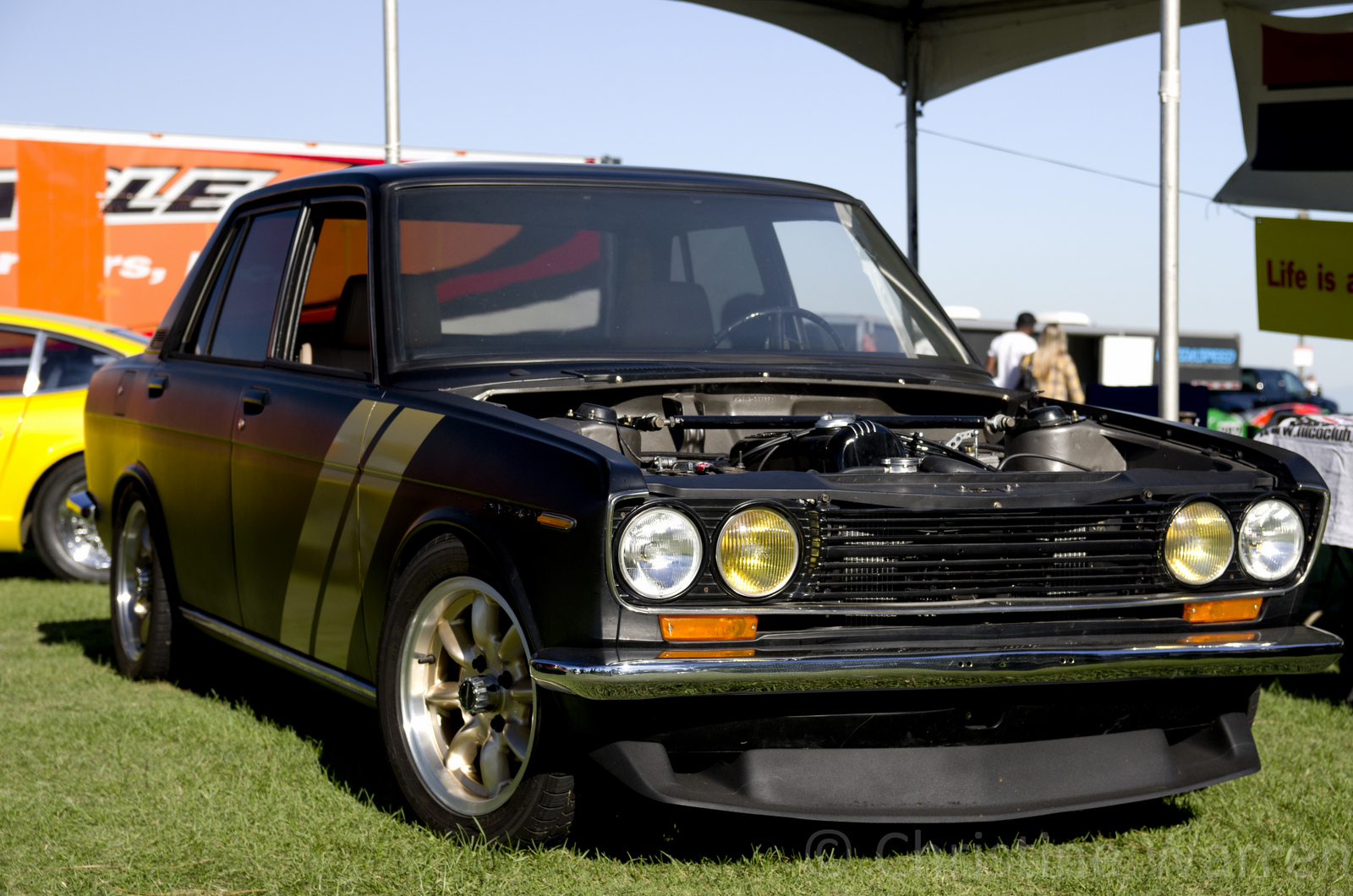

We left Thursday evening with the Bluebird, the 411 Wagon, and the Z, and our good friend James (greenblurr93) would leave Friday, towing the 510. The trip out was uneventful, but not for James – It seems the hood latch hardware loosened up during the drive, and the hood flipped up at freeway speed, bending it badly and damaging the cowl panel and hinges. Undeterred, he pulled the hood, threw it in his truck, and finished the trip. It’s a good thing we spent some time making the engine look good, because the 510 did the JCCS show hood-free.
Special thanks to Christine Warren (skydragoness) for the amazing pics!

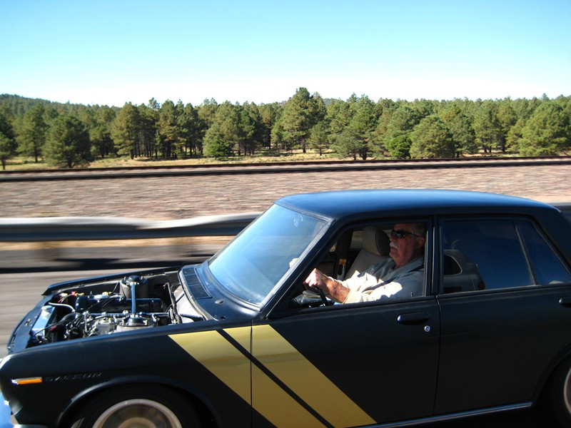

With no time to make repairs between the JCCS show and the event in Williams, all the cars got a quick once-over to make sure they were ready to make the trip. Our buddy ‘Doc’ would be driving the 510 to Williams, in a caravan with the 411 Wagon, the Roadster, the Z, and the Bluebird (on a trailer).
Doc driving the Dime:

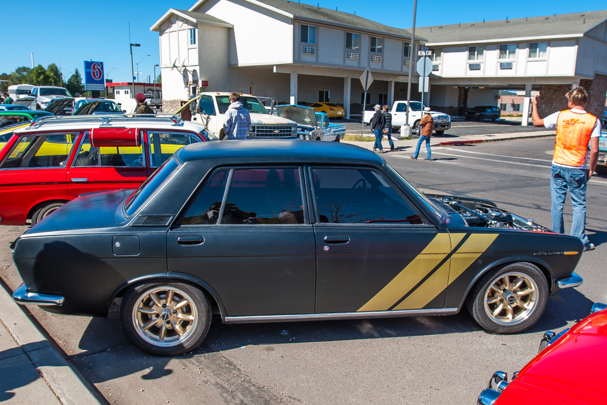

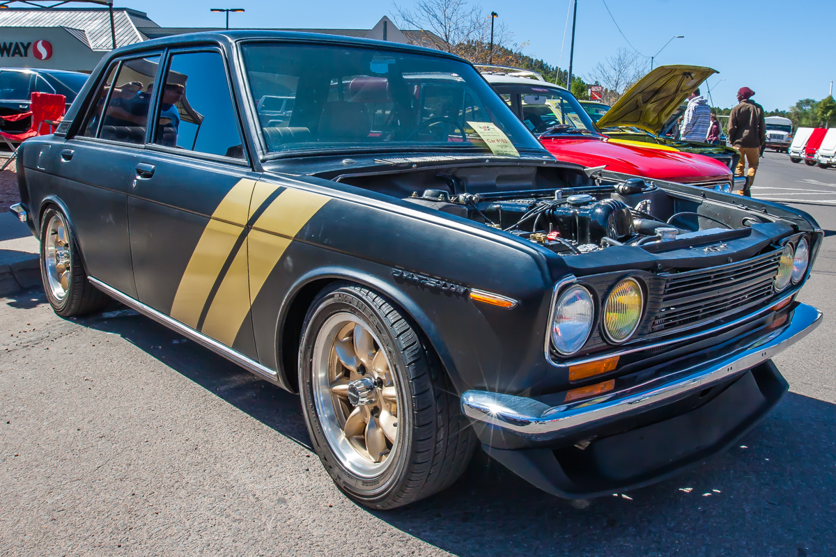

Williams is about 200 miles from NICO HQ, but with perfect weather and minimal traffic, it made for a spectacular drive. The 510 performed flawlessly, even though we went from 1000-ft elevation to over 7000 ft. The show was a success, and somehow she even brought home a 2nd-place trophy in the 510 class!
1380398_453587081426114_1636047455_n IMG_2053 IMG_2054
