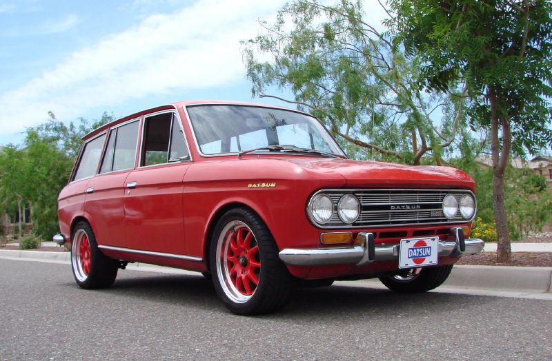

With the interior done, we were set to put some miles on our new acquisition. Just for fun, I threw on a set of GAB Sport wheels I sourced from Japan. They were sitting around from an abandoned previous project, and they looked good on the car, and saved me from having to buy new tires right away.
We posted up a few pictures and for a few months, we drove Alice around – short trips to the store, a few Datsun meets here in town, a couple trips here and there. We were amazed at the amount of attention and thumbs-up it got, even in its unrestored state. This car got more attention than our restored Datsun Roadster!
A little photoshoot before the restoration started:
