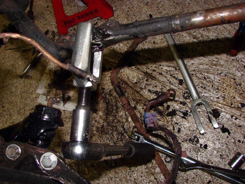

The steering on the wagon had gotten notably sloppy over 44 years, and part of the reason for all this suspension work was to make sure we had addressed the right problem. A sixteenth of an inch of “slop” in each part can add up to a quarter-turn in the wheel (and a harrowing driving experience). Aaron (Bwana) was out for the weekend and tweaked the steering box. This is a great starting point to assess how much free play is still left. While the steering box adjustment took up some of the slack, there was a lot left – Ball joints, bushings, tie rod ends, bearings… Everything is suspect on a car this old.
One of the first challenges we ran into was the fact that lower ball joints for the 411 have been pretty much non-existent for a decade. Nissan’s NOS stuff was sold out long ago, and due to the scarcity of the car, no one’s reproducing them. By a simple stroke of luck, while we were in California on vacation at Les’s shop, he mentioned he might have a couple laying around. Sure enough, he did. Not cheap, mind you – but when you HAVE to get the car back on the road, you do what you gotta do. The upper ball joints were sourced through a gentleman in Singapore, who I met through an ebay transaction. He turned out to be a pretty valuable source, as he also had inner and outer tie rod ends (great quality stuff from Triple-5, or 555 Parts, a supplier of OEM-quality parts to Nissan for years).
Success in finding most of the parts we needed increased our motivation, and Becky and I hit the garage hard on our days off. The JCCS show was only 3 months away, and we wanted her to make her debut there. First order of business was to start dismantling the front suspension. Since this was going to be a messy job, we laid down plastic drop cloths underneath the car, lifted her up on jackstands, and prepped for a long project. While we started disassembly, we enlisted the help of our son, Darian, to start removing all the road grime from the frame rails and underside of the car. Some “disposable” clothes, a pair of safety glasses, a paint scraper and cordless drill with a wire wheel was all he needed to be off and running. I’m pretty sure I swept up a 5-gallon bucket full of grime. We might make a Datsun restorer out of him yet.

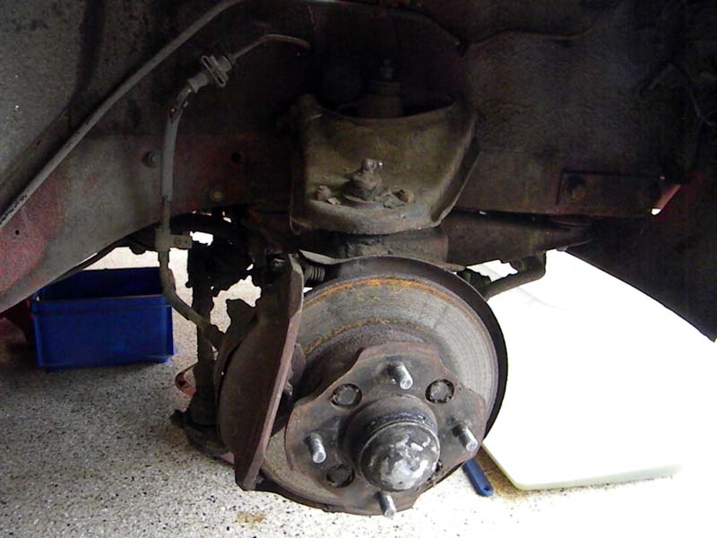

Have a look at the “starting point”:

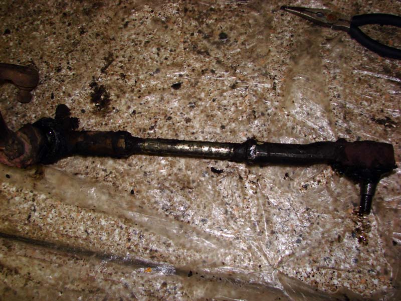

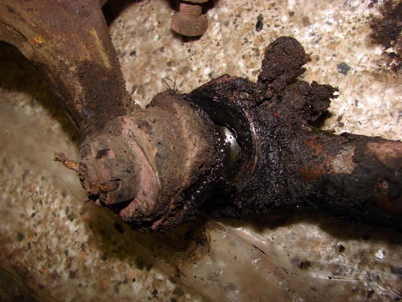

More of the “before” pics – Click on each one for a closer look. It’s no fun working in this nasty mess:

The upper and lower control arms were literally buried in nearly a half-inch of greasy, nasty mess. A couple hours with the wire wheel and some degreaser, and they got a fresh coat of black chassis paint. Those super-rare, beautifully-machined ball joints we were lucky enough to score went in cleanly, and all new Grade 8 bolts from my local Ace Hardware finished off the control arms.
