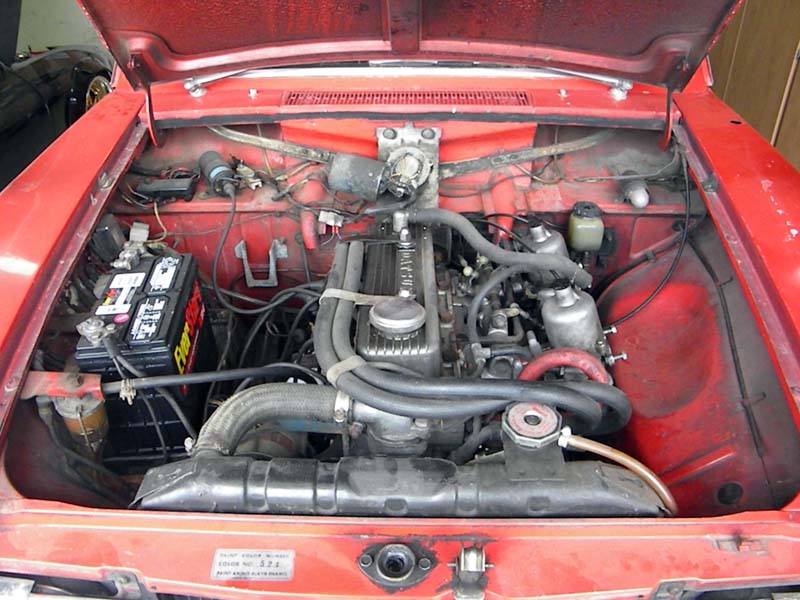

The cast iron exhaust manifold has a special extension bolted on which combines the 2 exhaust outlets into a single outlet and tilts it toward the new hole in the fender liner. The intake manifold is likewise tilted vertically to provide clearance for the SU air cleaner housing and the RL411 SU carburetors. Because of the tilt, the carbs’ fuel float bowl is tilted to the rear to keep the float level so that it doesn’t stick.

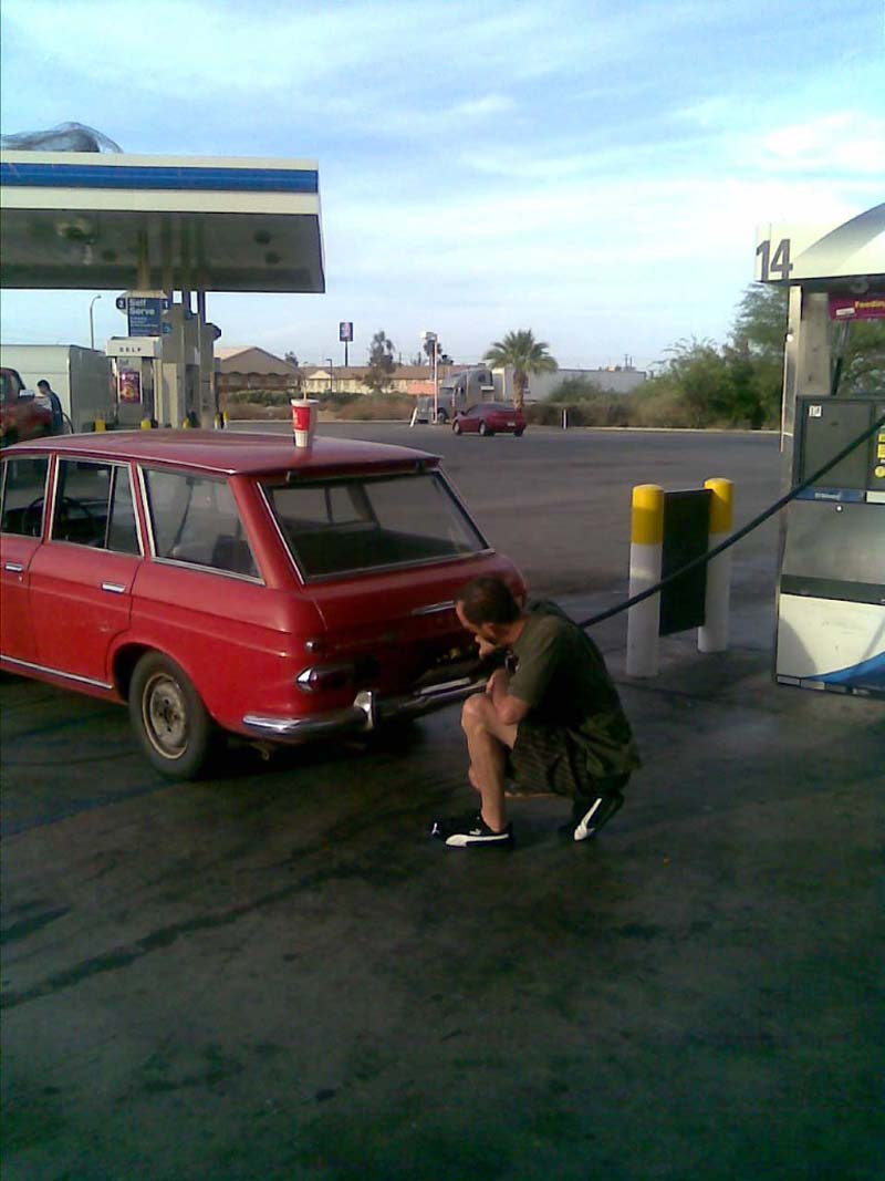

Here, in this picture, I’m refueling somewhere around the AZ border. Nothing too interesting about that, except that the fuel filler is located behind the license plate – but the plate won’t flip up or down! Quite a bit of searching revealed a small release button next to the hatch latch mechanism. Yes, you have to open the rear hatch to release the license plate latch, to access the fuel filler. That one almost stumped me.
