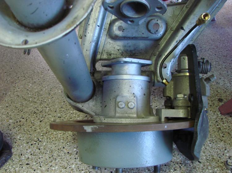

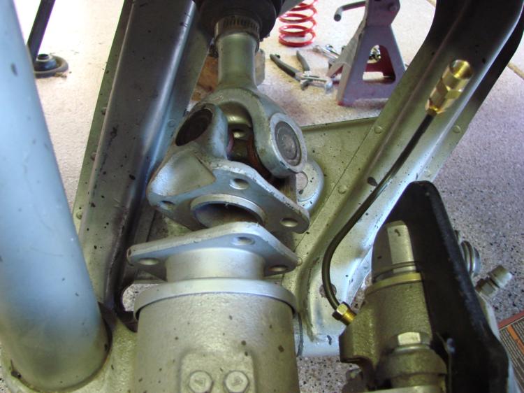

Now that the engine and trans were installed, the Z made its way back to our garage to await completion. Remember the parts car that had all the cool suspension and brake bits? They’d been collecting dust in the garage since the project started, so it was time to clean and paint everything in preparation for installation on the car.

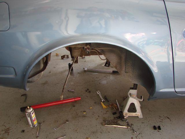

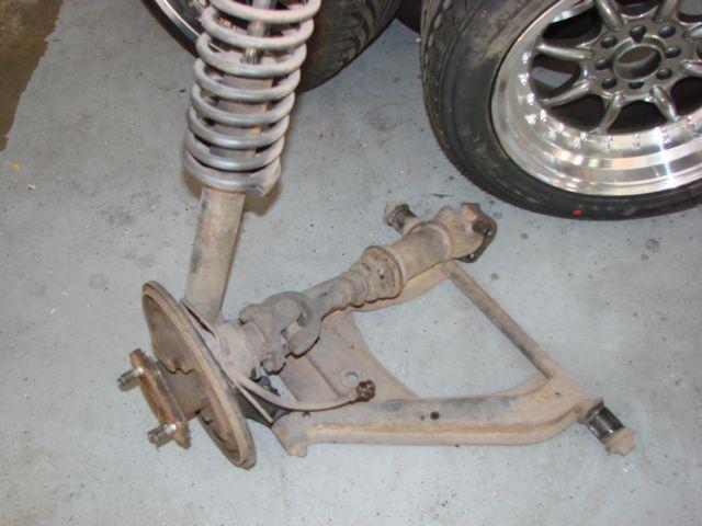

Removal and reinstallation of the suspension is pretty straightforward on an S30, so there’s not a lot of detail to go into. Pulling the old suspension components wasn’t too difficult, considering the car had spent its life in the desert – no rust to speak of, and not a lot of grime and gunk.
I was actually surprised at how easily everything came apart (also, a Dewalt 18v cordless impact wrench is the perfect tool for quick disassembly of stuff like this). Removing the old suspension components:

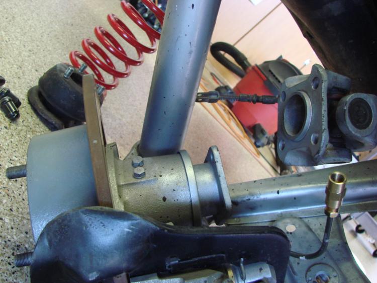

The calipers I’d refurbished early in the restoration went on, and I realized there was another small problem: I couldn’t find the stainless steel braided lines that came with the parts car! They were in one of the boxes of stuff, but just like several other small items, they somehow disappeared during the move. What to do? I didn’t even know what would fit. I mean, we’re going from the hardlines on the chassis (original Z stuff) to a set of late 80’s Toyota 4×4 truck calipers and 90’s Maxima calipers.
Online research didn’t yield much info, other than a lot of conversions using AN fittings – but I wanted something simpler. I had access to a local shop (Arizona Tube & Hose), and they’ve done some custom automotive plumbing for me before. Just for kicks, while at NAPA the next day, I asked if they had any old Datsun rubber brake lines. They had a set for a 520/520 pickup for under $10. I figured, “Well, at that price, even if one end doesn’t work, I can have the fittings cut off and used on a custom set.” On a whim, I test-fitted them in the Toyota calipers – BINGO. There’s no way they’d fit the Maxima calipers, right? Wrong. They fit there too! The only obstacle was that the Maxima calipers have an odd location for the line fitting, and it made the line interfere with the axle shaft as it rotated. So, I went back to NAPA and bought a short extension (with a female end and a male end), bent it 90 degrees, and attached it to the caliper – Perfect fitment.

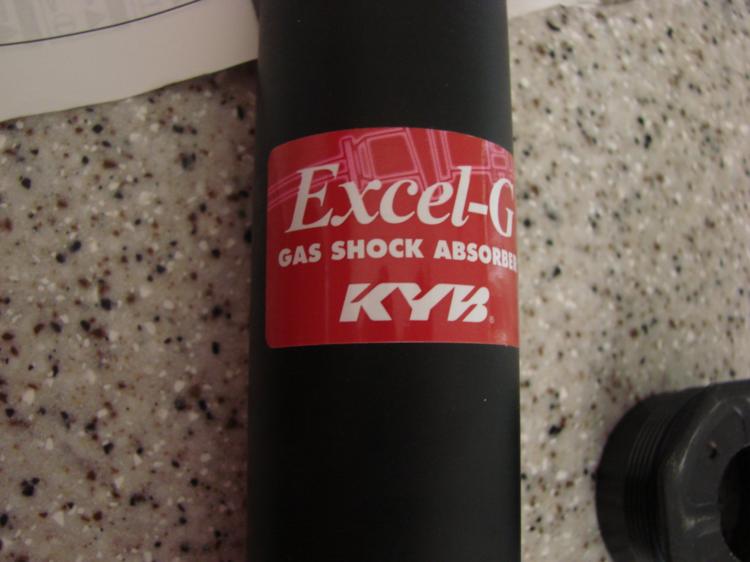

With the brakes bled and the wheels put on, it was time to come off the jackstands. However, once everything was put together, I found that the ride height remained obnoxiously high. Now, out of our 12 vehicles, the only one sitting at stock ride height is the Frontier, so this simply would not do… with no identifying numbers or marks on the obviously aftermarket springs, I had no way of knowing what they were or what car they were designed for – but it was clear they weren’t going to work out for this build.

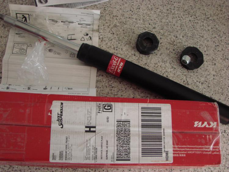

So, a quick call to Tokico and a set of lowering springs were on the way. The blue “unknown” springs were removed and replaced with the red Tokico units, and a fresh set of KYB strut inserts were added to make sure the ride was well-damped.
Replacing the springs and shocks on an S30 isn’t a real difficult affair, but having an extra pair of hands to help is a must – thankfully, Becky knows her way around the garage and with her assistance, we made quick work of the task. As soon as we set it back on the ground, we knew we had the stance just right.
