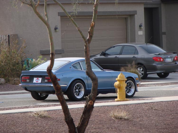

With everything buttoned up, it was time for the Z to take her maiden voyage. Let’s ignore the fact that for an engagement gift, it was a year late… So on SuperBowl Sunday, Becky got the keys to Bella and took her for her first drive. Her expression was priceless, and despite the fact that NOTHING had been “sorted” on the car, she was as excited as could be… Never mind the fact that it was built by a couple knuckleheads in a garage, she romped on the throttle and made sure all the neighbors heard it – and the sound of that RB under load through a 3″ dump is simply amazing.
I think she likes it.
Side note: Speaking of “sorting”, this is kind of an archaic term you’ll hear tossed about by restorers and hot rod builders. Simply put, it means the process of making a newly-built car driveable. Even a well-planned project will have bugs and kinks that won’t reveal themselves until that first drive. It’s important when sorting a vehicle that you take a passenger along with a pad and pen (or a digital voice recorder) to jot down all of your impressions. For example, Becky noticed several things that needed to be addressed: The brakes are overly touchy and engage too high in the pedal travel. Similarly, the clutch engages too early in pedal travel as well. The rear end squats on moderate acceleration, rubbing the rear tires on the fenders. The front tires scrub the air dam on sharp turns, and the seat belt buzzer decided to magically “re-connect” itself halfway through the shakedown run… and, as you heard her mention, it acted like it wanted to die out a couple times. All things that could be addressed.
