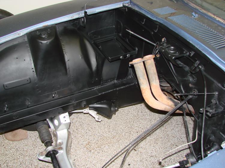

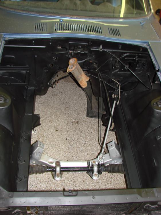

In preparation for loading the engine back in the car, I did some work on the engine bay. Most of the unnecessary holes were filled, seams covered with POR-15 seam sealer, and a fresh coat of flat black covered the metal. I considered shooting it with the body color, but that would have necessitated fender removal, as well as refurbishing the crossmember, steering rack, and a lot of other parts that I wasn’t interested in dismantling.

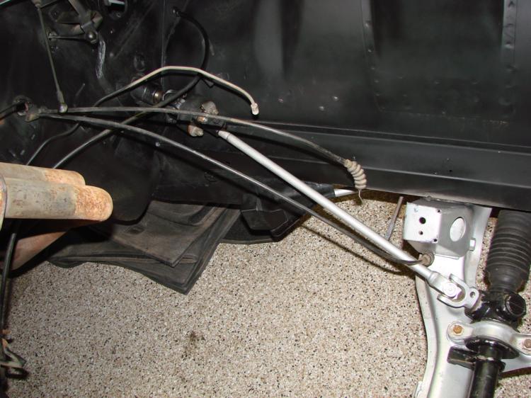

Those of you who have done a build or a restoration know that sometimes, you go through a phase where you just want to do little half-day projects… those small tasks that can be knocked out in three to five hours. That’s where I was. I suspected I’d be challenged to make time for reinstalling the engine, so I got a few little jobs done. First, I installed the larger booster and master cylinder that was on the parts car. This, of course, placed the brake lines in a little different position, so there was some re-bending involved… but it came together nicely.

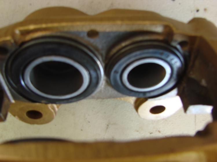

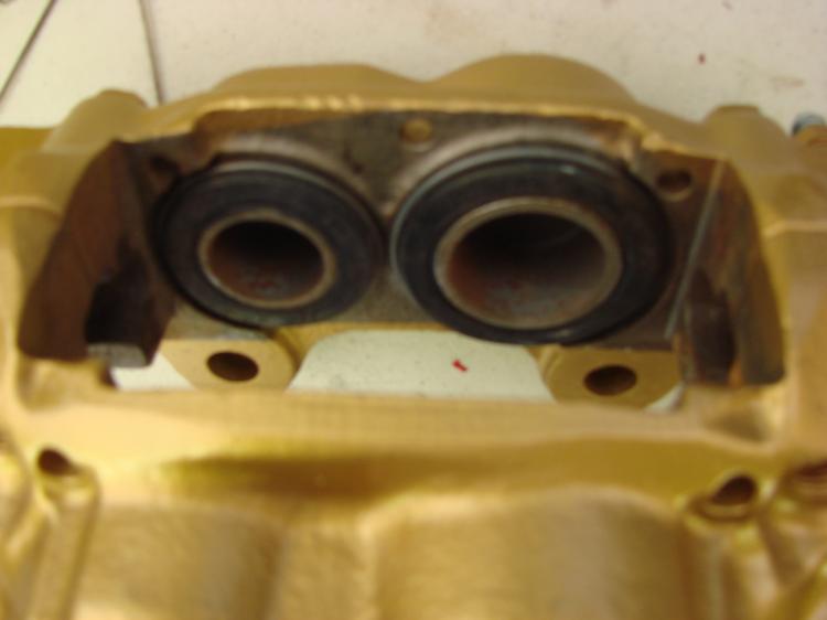

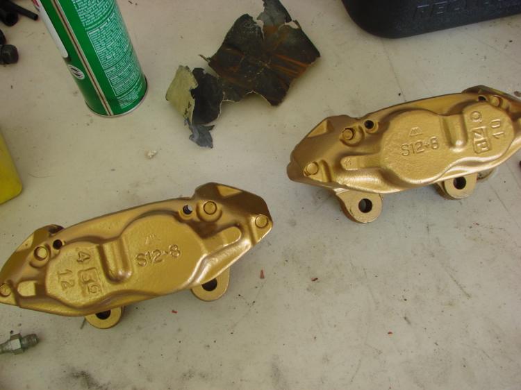

While unpacking some stuff in the garage, I ran across a rebuild kit I had ordered for the front calipers. A quick beadblast made short work of the nasty finish. New seals, hardware, and a fresh coat of gold caliper paint gave them new life – these would definitely outperform the stock brakes!
